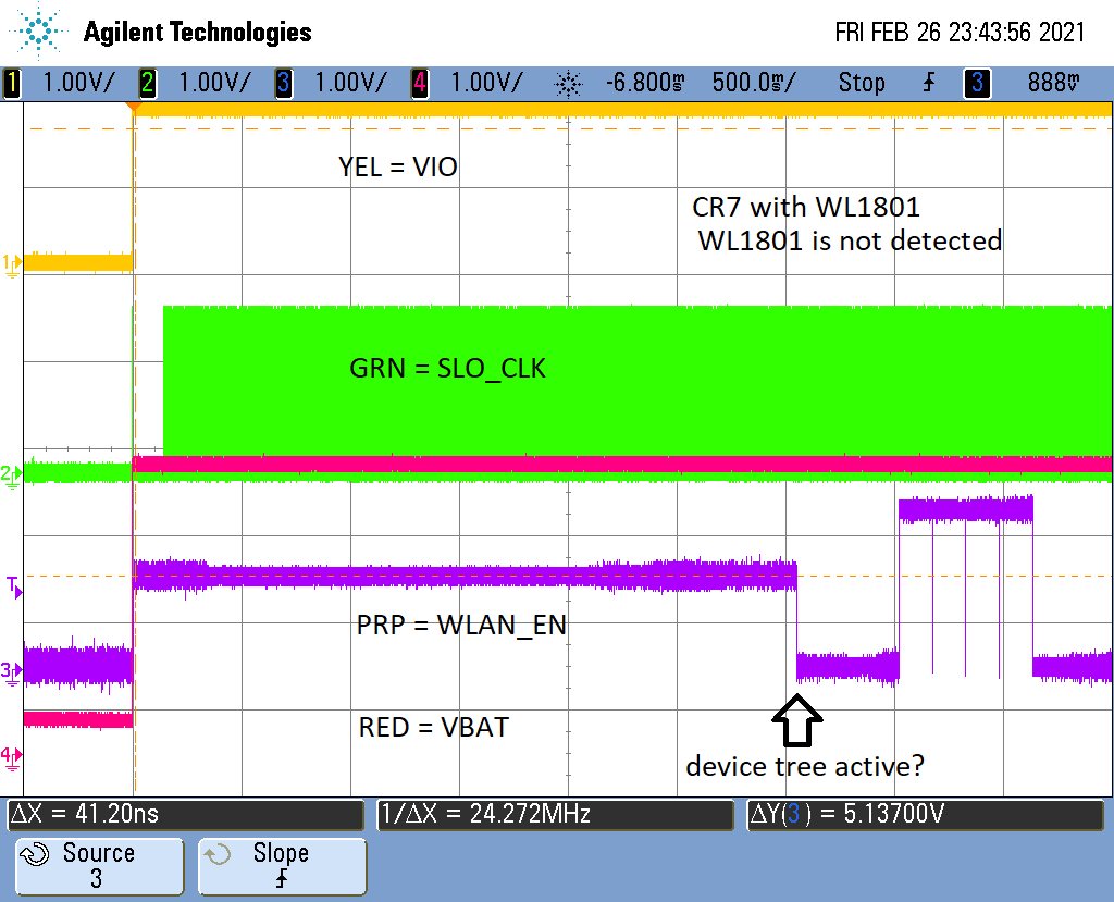

WL1801 has replaced TiWI-BLE (WL1271) in a design using i.MX6 (ARM) platform.
OS is yocto 3.10
Wilink8 is used. Ti-compat-wireless 3.11.18-r8.a9.22
TiWI-BLE used SMD_CLK of 25MHz while WL1801 run at 50MHz.
I have 0.3% failure rate with WL1801.    The WL1801 fails to be detected.
Can I limit the SMD_CLK to 25MHz with WL1801?  I want to see if the slower clock rate would impact the failure rate.
Setting max-frequency = <25000000>;  in the device tree did not influence it.

    Failure mode:  SMD detection process never reaches HI-SPEED mode.
    SMD messages captured are:
    CMD 52 Clear I/O Abort register
    CMD 52   Set RESET bit in I/O Abort register, it will auto clear
    CMD 0
    CMD 8
    CMD 5   IO_SEND_OP_COND
    CMD 55
    CMD 55
    CMD 55
    CMD 55
    CMD 1
    Modules loaded: compat   wlcore_sdio
    Modules failed to load:   cfg80211  mac80211   wlcore   wl18xx
    wlan0 is not present, thus nmcli d wifi fails.
    In all instances, wifi function (nmcli d wifi) works during a pretest of the system.
    It is during subsequent boot cycles that we run into this behavior.

    I have attached the wifi portion of the schematic.
    It was designed around WL1837, but went into production with WL1801.
    I have also attached a scope shot of startup of a unit that will no longer recognize WL1801.
    The one concern is WLAN_EN rises to 1V until probably the devicetree is read.
    I have added an external pull down resistor here, but have not seen any change in behavior.
    However the datasheet mentioned damage could be done to the part if an invalid power up sequence is used.
    So I am not ruling this out as being the root cause.
    Thoughts?
    eMMC_BT_WIFI.pdf
    Thanks for sharing!! Do you have the waveform capture from a goof unit? Please refer to the data sheet (https://www.ti.com/lit/ds/symlink/wl1801mod.pdf?ts=1614634205854&ref_url=https%253A%252F%252Fwww.ti.com%252Fproduct%252FWL1801MODfor the power up sequence. We need to have RTC clock enabled before VBAT and VIO for normal operation. Also need to have the WL_EN ON after we have the VBAT ON. Please make sure you have the timing correct as shown below.
    Also WL1837MOD supports dual mode operation. This means the module may have multiple antennas. However WL1801MOD supports only 2.5GHz band and doesn't support BT. So this module will just need a single antenna. Please make sure you have this antenna configuration and also make sure that the configuration file is updated to reflect the same.
    Sudharshan K N
    Are you positive the clock needs to be present before VBAT rises?
    From the datasheet, VBAT and VIO appear to rise before the clock starts.
    Please refer to figure 5.2 for details of the timing needed. Fig 5.4 provides with all signals included including TCXO. In the plots sent earlier, it did not seem like WL_EN is ON before RTC clock is enabled.
    Sudharshan K N
