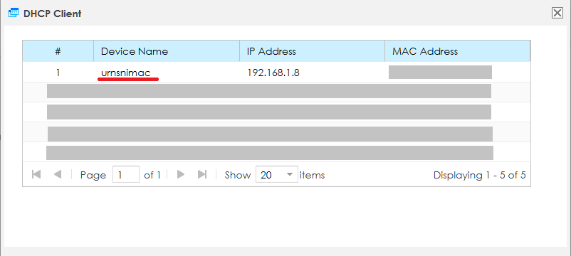

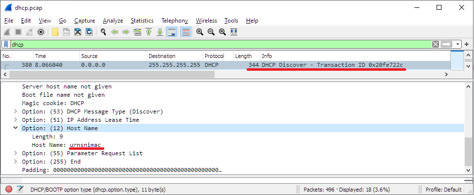

    Hostname of client is provided via DHCP option 12 (this way is used with any other device as well). This option is configurable at CC32xx device side via URN setup. In case of DHCP hostname is now showing for CC32xx there are options:
    • CC32xx device uses static IP and not DHCP (without enabled DHCP at client side this cannot work)
    • you have not properly set URN at CC32xx device
    • not properly configured network infrastructure
    If you want deeply debug this issue you should capture DHCP Discover package from CC32xx device and check content of the option 12.
    For example from my CC3220SF device:
    DHCP discover:
    DHCP client list at firewall / DHCP server:
    Jan
