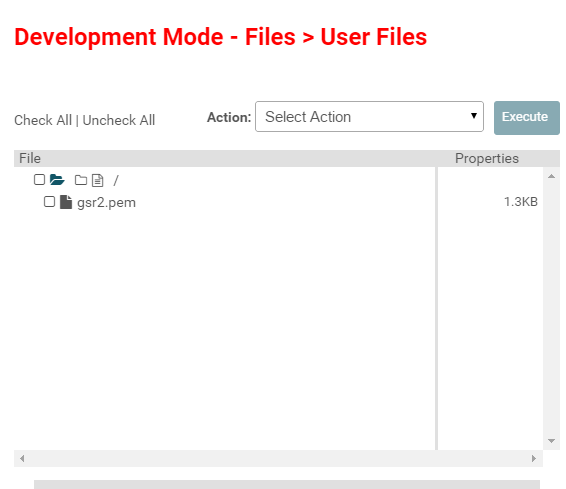

I upload them as such via Uniflash :

    Error -468 is SL_ERROR_BSD_ESECUNKNOWNROOTCA, which may mean this was the correct certificate, but the CC3220SF was unable to verify it in the trusted root certificate catalog.
    You can find all the error codes in source/ti/drivers/net/wifi/errors.h.

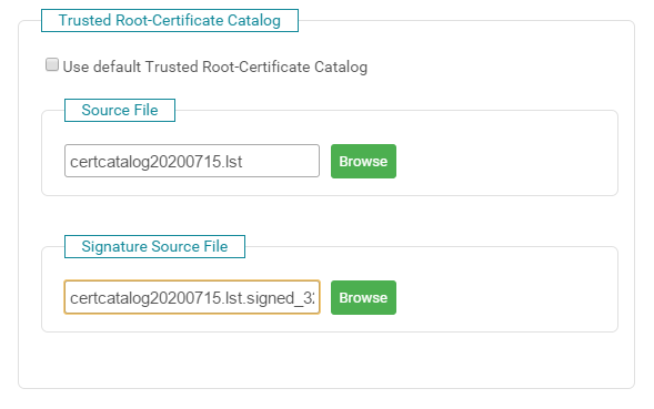

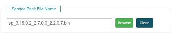

    Can you check what servicepack and certificate catalog you have flashed to the device? You can find the latest version of the servicepack and the certificate catalog in the SDK's tools/cc32xx_tools folder.
    Sarah
  • Hi!
    I'm currently using the latest SDK version simplelink_cc32xx_sdk_4_40_00_07.
    From the SDK I flashed the following servicepack :
    And the following certificate catalogs  :
    with certcatalog20200715.lst.signed_3220.bin as the signature source file.
    I'm still experiencing the same issues.
  • Hi Yining,
    You need to find the root CA certificate that is signed by a trusted certificate authority (listed in the certcatalog readme). This root CA cannot be self-signed by Google. Since the connection response from Google is asking for a GlobalSign certificate, I suggest trying those first.
