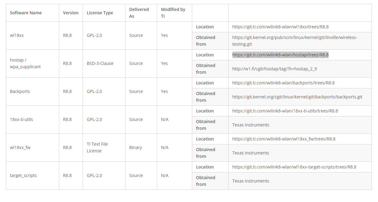

  • How do I get the source to build this driver?  I tried this document, but some of the URLs display a page indicating R8.8 is an invalid branch.
    software-dl.ti.com/.../WiLink8_R8.8_manifest.html
    Please refer to https://www.ti.com/lit/ug/swru561a/swru561a.pdf for details on integration.
  • I have read that guide.  I am trying to pull this build into a yocto image, so I need URLs to the source for the packages listed in the Build User's Guide.  The manifest page lists several repos, half of which do not work.  I am not building this on the target, I am building it in a yocto cross-compiled environment, which means I need to add recipes and/or patches to build this driver for my project.
    Can you please let us know which of the links are not working? You can refer to configuration.sh within the build_utilities for the paths to the required components.
    Sudharshan K N

  • Thanks.  I presume I should be using branch 'r8.8' of the build utilities repo.  Is that a correct assumption?
    Broken URLs
    WL18xx driver:  https://git.ti.com/wilink8-wlan/wl18xx/trees/R8.8
    Backports: git.ti.com/.../R8.8
    WL18xx_fw: git.ti.com/.../R8.8
    Yes. The R8.8 configuration.sh is a better place to look into.
    we will check and see why the R8.8 label is missing
    R8.8 doesnt support backports.
    we will check why the R8.8 is not applied. The latest version of FW is 8.9.0.0.86.
    Sudharshan K N
