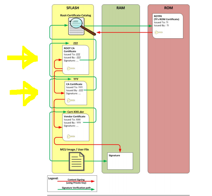

We are using TI OTA_Lib to implement firmware updates on device with CC3220SF (MODASF to be precise).  As we want in some cases to use updates from SD card rather then download form web, we are bypassing part of OTA_Lib interface and using OTA_Archive directly.
Our app does following:
1. OTA_init is called
2. We are using exporting value of OtaLib_t *pOtaLib from OtaLib.c
3. Chunk by chunk data from update.tar on SD card is sent to OtaArchive_process using (&pOtaLib->OtaArchive) as first argument.
4. After reboot and OTA_init  OTA_get with EXTLIB_OTA_GET_OPT_IS_PENDING_COMMIT used to check whether there is pending commit or not and after that rollback or commit new image.
Usually it works good, but if update is interrupted (we are simulating power loss) during unpacking of root or intermediate certificate, all consequent update attempts will fail: OtaArchive_process will return ARCHIVE_STATUS_ERROR_CLOSE_FILE and following log will be printed to log:
OtaArchive_RunParseTar: error on pCloseFile, Status=-10288
OtaArchive_Rollback: ERROR sl_FsCtl, Status=-10282

  • Hello Sarah,
    These certificates are part of certificate chain used for signing firmware image binary. Here is picture from swpu332, I marked certificates I am talking about with yellow arrows.

  • Hi Sarah
    What exactly do you mean ?
    From what I see those certificates are already failsafe, but on next load (after interrupted update) certificate which was not closed before reboot is marked as "No valid copy". They are not rolled back because they are not part of the bundle.
    By the way I reflashed my device and simulated interrupted update once more, now I get slightly different errors in logs, but device still won't update:

  • Hi Vadym,
    It sounds like your issue is that the certificate is corrupted when you remove power during the update. Error -10288 means the file has not been closed correctly. "No valid copy" occurs if the file was created without a failsafe flag.
    Can you share how you are configuring the certificate? Are you adding this in the application or the ImageCreator tool?

  • Hi Sarah
    We are using following commands to invoke imageCreator and add certificates:
    "./$IMAGE_CREATOR_BIN" project add_file --name "$IMAGE_NAME" --file "$DIST_CERT_ROOT" --fs_path "$DIST_CERT_ROOT_NAME" --overwrite --max_size $DIST_CERT_ROOT_MAXSIZE
    "./$IMAGE_CREATOR_BIN" project add_file --name "$IMAGE_NAME" --file "$DIST_CERT_INTERMED" --fs_path "$DIST_CERT_INTERMED_NAME" --overwrite --max_size $DIST_CERT_INTERMED_MAXSIZE
    path to imageCreator binary is substitiuted as IMAGE_CREATOR_BIN
    DIST_CERT_ROOT_NAME and DIST_CERT_INTERMED_NAME are names for those certificate files under which they will appear in simplelink FS
    Should we add --flags failsafe option to these lines?
  • Hi Vadym,
    Yes, exactly. This flag will instruct the filesystem to keep a backup copy of those certificates, so if you remove power while those files are open, there is still a valid copy.
