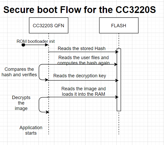

  • Just for more clarification, I drew a diagram of what I think is happening in the secure bootflow, can you confirm this or make any suggestion on how it is different?
    (I'm a bit more of a visual learner, so this just makes it easier for me to understand :D)
  • Hi Vasav,
    I think there are a lot of details you could go into and represent, but that they aren't necessary to capture. I believe you have a solid understanding of how it works. One note for your representation may be to not mix "user files" and "image" terms. Here I think we have been focusing on the MCU binary specifically. That might be confusing.
    Also, I believe the "hash" should be represented as performed on the plaintext rather than the encrypted version of the file, so you might have some pieces a little out of order unless you are just showing a high-level representation.
