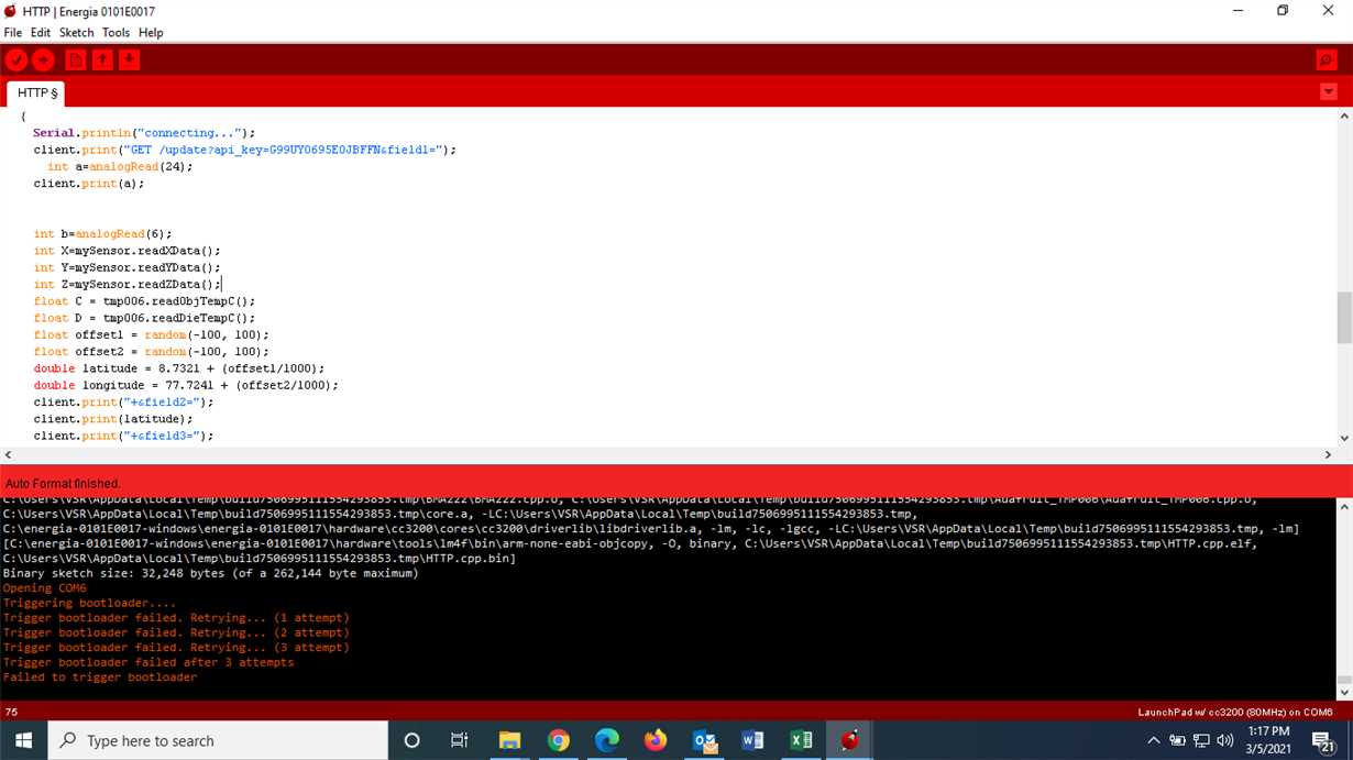

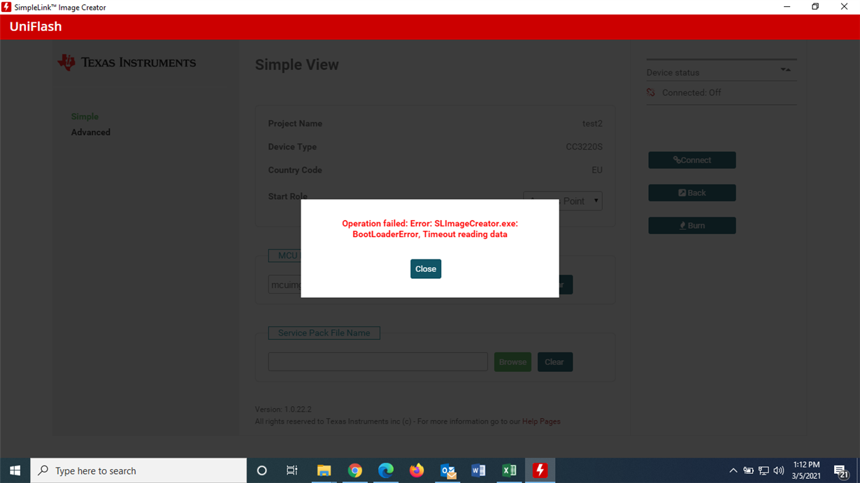

Hi
In some of the EVM i am getting the error " Bootloader Error".
This i am noticing in uniflash , Energia.
Would like to know the possibility of loading bootloader image on to the device . i am unable to get the Boot loader program for CC3200.
  • E nclosing the Screen shot of the error
  • Enclosing the screen shot

    btw ... for CC3200 devices you need to use Uniflash v3.x not a latest versions.

    As Jan mentioned, Energia is not directly supported on E2E and you will need to ask the 43oh forum for help on your precise bootloader issue.
    Now, it does appear that there are two parts to your issue:
    1. The Energia program doesn't appear to be able to invoke the bootloader correctly
    This is probably because you cannot load code directly through UART on the CC3200 - you need to use JTAG, and have a specific JTAG profile specific to the CC3200. Check your energia target settings to ensure that this is the case.
    2. Uniflash is unable to program the CC3200 binary
    You need to use version 3.x of Uniflash, not v4+. This is since only the older versions of Uniflash have the needed support for the CC3200 bootloader. Once you use the older version of Uniflash, you should be able to program the device with the binary generated by Energia.
