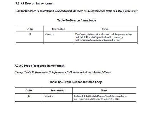

Hi all,
When 802.11h is enabled, 802.11d is enabled too.
Why isn't it able to enable only 802.11h?
I would like to disable 802.11d and enable only 802.11h.
  • IEEE 802.11h standard states that AP must have Country IE enabled when 11h is enabled.
    As a station we need to support 11d when 11h is enabled since we need to know the country in which we are at to support the power constraints.
    From the 802.11h standard:
