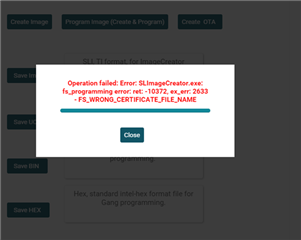

I am trying to Flash local Ota demo example by using Uniflash project.
1. Imported Uniflash project from <C:\ti\simplelink_cc32xx_sdk_4_40_00_07\examples\rtos\CC3220SF_LAUNCHXL\demos\local_ota\uniflash>
2. Removed sys/mcuflashimg.bin and tried to add bin file which is created by IAR.
3. While programming image I am facing the issue "Operation failed: Error: SLImageCreator.exe: fs_programming error: ret: -10372, ex_err: 2633 - FS_WRONG_CERTIFICATE_FILE_NAME"
SDK : simplelink_cc32xx_sdk_4_40_00_07
IAR : 8.40.2 version.
Please find the below screenshots for more details.
Please help me resolving this issue.
Suresh

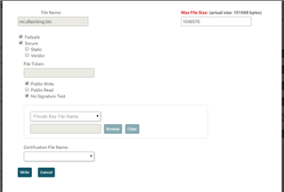

  • When adding the MCU image you need to sign the image using a private key (e.g. using the "dummy" Playground certificate store, you can use: "dummy-trusted-cert-key") and provide the corresponding certificate that exists on the file system (e.g. "dummy-trusted-cert"), to verify it. This should be done in the file properties windows. If you provide a certificate that is not self-signed (i.e. root CA) you will need to include the entire chain (e.g.  "dummy-trusted-cert", "dummy-trusted-cert", "dummy-trusted-ca-cert", "dummy-root-ca-cert").
    See more details in www.ti.com/.../swru469
