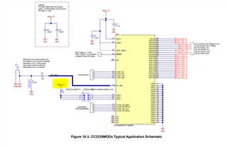

Hi TI,
In the CC3235MODx Typical Application Schematic (Figure 10-3 in datasheet), Does it make sense to connect SOP1,2 and 3 to VBAT_CC which can be unstable? I am asking because I am using CC3235MODSF in a PCB that I am designing so I am confused about this VBAT_CC.
Brahim
