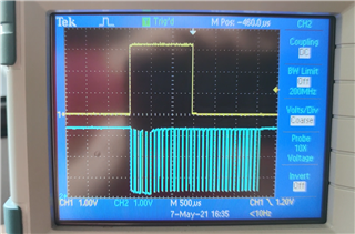

Currently, we are developing a product at CC3220S that utilize UART2 for establish RS485 communication. To do so, controlling of read/write enable pin is a critical point (RS485 is half-duplex). Therefore, write callback is to be used. As we could learn from API there are two ways:
1)
    uartParams.writeMode = UART2_Mode_CALLBACK;
    uartParams.writeCallback = callbackFxn;
2)
    uartParams.writeMode = UART2_Mode_NONBLOCKING;
    uartParams.writeCallback = NULL;
    uartParams.eventCallback = eventFxn;
    uartParams.eventMask = UART2_EVENT_TX_FINISHED;
Unfortunately, both do not work as intended.
In 1) approach, the callbackFxn is called in completely non-deterministic manner. It is somehow related to TX ring buffer size (set in SysConfg) and transmitted data size. This callback is unpredictable so not very useful in our application. At the bottom I attach some example code. Perhaps, I do something wrong? Below, I attach some screens from oscilloscope (yellow falling edge - start transmission, rising - callbackFxn). In both cases transmitted data size is 46 bytes:
a) TX ring buffer 64 bytes:
b) TX buffer 16 bytes:
2) approach is much more deterministic but eventFxn is always too early. For me, it looks like DMA (which unfortunately cannot be disabled in this MCU) generate interrupt at the beginning of transmitting the last data chunk to the peripheral. Generally, for 115200 this event is called 1,5 ms before end of transmission, see pictures below:
Note that this issue cannot be reproduced with just debugger breakpoint because breakpoint does not halt the DMA.
Could you help me solve this problem? Of course, we could put timeout in the callback but it is workaround in bad style.

    The callback can actually occur not only for the when a transmission completes, but also for other reasons, generally related to errors. Have you checked the event provided in the callback to ensure that it is UART2_EVENT_TX_FINISHED, and not another event?
    If there does seem to be some timing issue with the callback and the UART writes, you can try using the non-DMA version of the UART driver. Currently, it looks like you are using UART2. There is a separate UART driver, which has the ability to disable DMA.
    If you use the UART (and not UART2) driver, and disable the use of DMA, then the write callback should only be issued once the UART is no longer busy, thus preventing the timing issue you are seeing.
    Michael
    thanks for your response.
    Yes, as you could see in both examples above, I have been checking either event or status in callbacks:
    void eventFxn(UART2_Handle handle, uint32_t event,
                  uint32_t data, void *userArg)
       if (event != UART2_EVENT_TX_FINISHED) {
           /* RX error occured in UART2_read() */
           while (1);
    void callbackFxn(UART2_Handle handle, void *buffer, size_t count,
            void *userArg, int_fast16_t status)
        if (status != UART2_STATUS_SUCCESS) {
            while (1);
    So, it was not the case.
    Following your suggestion, I have migrated my design to UART driver and it works as intended for both DMA and non-DMA variant. It looks the UART2 driver does not work properly in this aspect.
