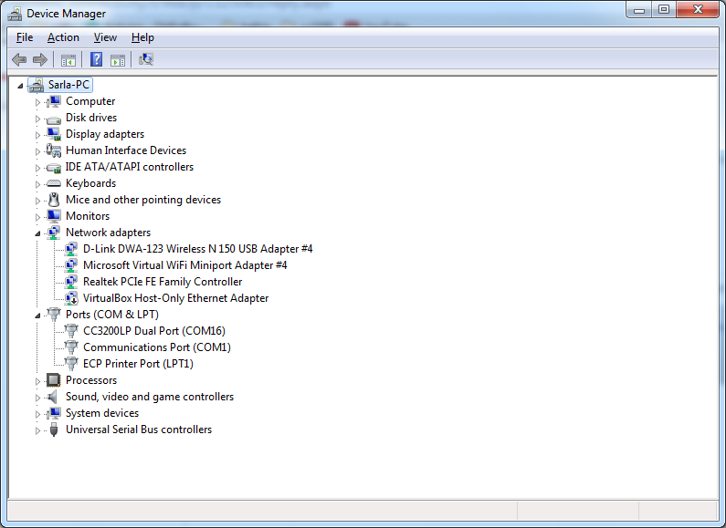

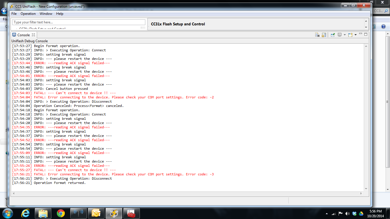

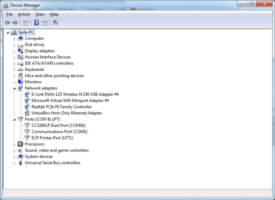

    I am also facing the same problem!!
    I tried wat all in this forum but it didnt worked out.
    I am using Windows 7 SP1
    CC3200 Lauchpad version rev 3.2
    My console output is same as here
    [17:53:27] Begin Format operation.
    [17:53:27] INFO: > Executing Operation: Connect
    [17:53:29] INFO: setting break signal
    [17:53:29] INFO: --- please restart the device ---
    [17:53:44] ERROR: ---reading ACK signal failed---
    [17:53:46] INFO: setting break signal
    [17:53:46] INFO: --- please restart the device ---
    [17:54:01] ERROR: ---reading ACK signal failed---
    [17:54:03] INFO: setting break signal
    [17:54:03] INFO: --- please restart the device ---
    [17:54:03] INFO: Cancel button pressed
    [17:54:03] FATAL: --- Can't connect to device !! ---
    [17:54:04] FATAL: Error connecting to the device. Please check your COM port settings. Error code: -2
    [17:54:04] INFO: > Executing Operation: Disconnect
    [17:54:04] Operation Canceled: Process<Format> canceled.

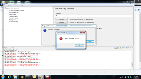

    [17:54:18] Begin Format operation.
    [17:54:18] INFO: > Executing Operation: Connect
    [17:54:20] INFO: setting break signal
    [17:54:20] INFO: --- please restart the device ---
    [17:54:35] ERROR: ---reading ACK signal failed---
    [17:54:37] INFO: setting break signal
    [17:54:37] INFO: --- please restart the device ---
    [17:54:52] ERROR: ---reading ACK signal failed---
    [17:54:54] INFO: setting break signal
    [17:54:54] INFO: --- please restart the device ---
    [17:55:09] ERROR: ---reading ACK signal failed---
    [17:55:11] INFO: setting break signal
    [17:55:11] INFO: --- please restart the device ---
    [17:55:26] ERROR: ---reading ACK signal failed---
    [17:55:27] FATAL: --- Can't connect to device !! ---
    [17:56:21] FATAL: Error connecting to the device. Please check your COM port settings. Error code: -3
    [17:56:21] INFO: > Executing Operation: Disconnect
    [17:56:21] Operation Format returned.
    And I tried to press the Reset button to restart the device, but it seems no use at all.
    For the other options, e.g. Program, Service Pack Update, and Get Version, all failed similarly.
    Previously i programmed this board with Uniflash and i am also using Energia and the board was working fine
    I was just formating it as it was not detecting the wifi signal which my fone is receiving but then it stop in between the format and then it never formated nor any othre option like get Service Pack update or get version
    I closed all the other programs and tried but it didnt worked so restarted the PC but no luck then changed the PC and tried with other PC but it didnt worked out.
    Tried this also but didnt worked out
    • Close Uniflash and other serial console that uses the same COM port as your Launchpad.
    • Power Off and On your CC3200 Launchpad. Make sure the jumper is connected at SOP2
    • Open Uniflash and try to load program again. Make sure you set the correct COM port at Uniflash.
    Please guide!!
  • Hi Amir,
         Your Uniflash COM Port is set to 16. Are you sure that is correct? You, can confirm this at your Device Manager. My COM port for my CC3200 Launchpad is usually 5 and sometimes 7.
    - kel

  • Hi Tom,
    We will contact you offline via Email to get you a new board.
    In addition, please note that a new production Service Pack has been released (v1.0.0.1.1).
    Make sure you start using it instead of the pre-production Service Pack.
    I'm closing this thread.
    Shlomi
