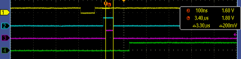

On CC3220MODASF Launch Pad "LAUNCHCC3220MODASF",
interrupt latency looks like periodically get longer.
Usually, it's approx 3us, but periodically get 10us.
For more details, show the graph below.
This is the result of my sample program.
In my project, CPU must respond within several microseconds.
Therefore this latency is a issue to be solved.
How can I make the latency at around 3us constantly?

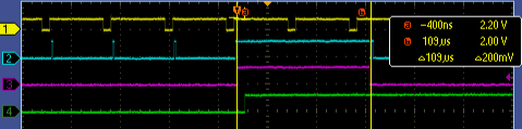

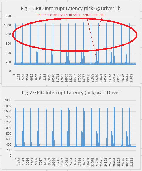

  • Hello, Michael,
    I've attempted modifying my application following your suggestion.
    In my application, I use the interrupt from GPIO28 and along with WLAN transmission.
    There are some spikes happened, especially right after WLAN transmission.
    I attach the sample program, that consist of two files.

    The result of my sample program is shown below.
    Case 1) Use DriverLib ->Fig.1
    Case 2) Use TI Driver (Comment out the line 24 "#define USE_DRIVERLIB_INSTEAD_OF_TIDRIVER") ->Fig.2
    I have two question.
    1) How can I remove the spike latency?
    2) GPIO9 indicates execution time of Semaphore_post.
    It usually (case 2) takes 3us, but in case 1, it's about 100us.

  • There are some additional information.
    The timing chart of case 1 is shown below.
    1) GPIO10: PWM06 -> GPIO28 as interrupt source
    2) GPIO11: gpio28Callback
    3) GPIO9: Semaphore_post
    4) GPIO8: sl_Send in sendTask (10ms+)
    In this case, Semaphore_post takes 109us, it's so long.
    The timing chart of case 2 is shown below.
    In this case, Semaphore_post takes 3us, it looks like no problem.
    Nobuhiro

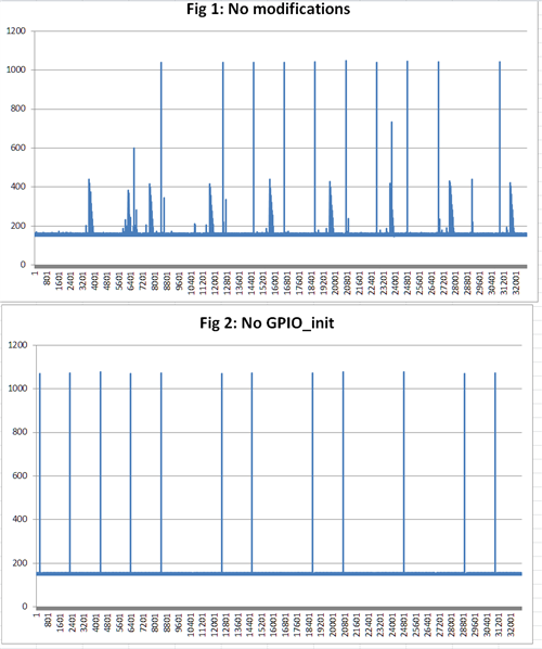

  • Hi Nobuhiro-san,
    Following your instructions, I have reproduced the latency issue that you are seeing.
    For the small delay that you are seeing, it seems like you can eliminate it by not calling GPIO_init(), and only using driverlib calls to setup all of the GPIOs, including the debug GPIOs.
    With the following code:

    I get the result in figure 2:
    As for getting rid of the larger delay, I believe that this delay is due to the RTOS performing a context switch when the semaphore_post() unblocks your sendTask.
    Here is benchmark of the TIRTOS delays. Looking at the table, the delays for posting a semaphore are quite high but should not be >1000 cycles. I'm not sure how you would be able to optimize that semaphore delay.
    One workaround to remove the delay would be to remove the semaphore and instead replace it with a global flag that your sendTask reads in a loop. Something like this eliminates the large delay:
