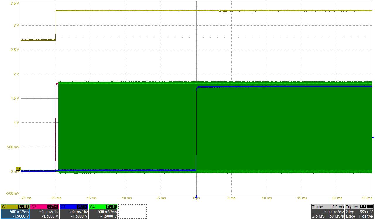

  • Hello Seong,
    at first thanks for your reply.
    The design include a module with board-to-board connector, and the SD2-Interface is working well with a starterkit.
    The CPU is an i.MX6D.
    Yes I have already checked the signal with a probe.
    The following figure shows:
    Yellow = V_3V3_WLAN (VBAT_IN) ; red = V_1V8_WLAN (VIO_IN) ; blue = WLAN_EN_1V8 (WLAN_EN) ; green = EXT_32k (32.768 kHz oscillator)

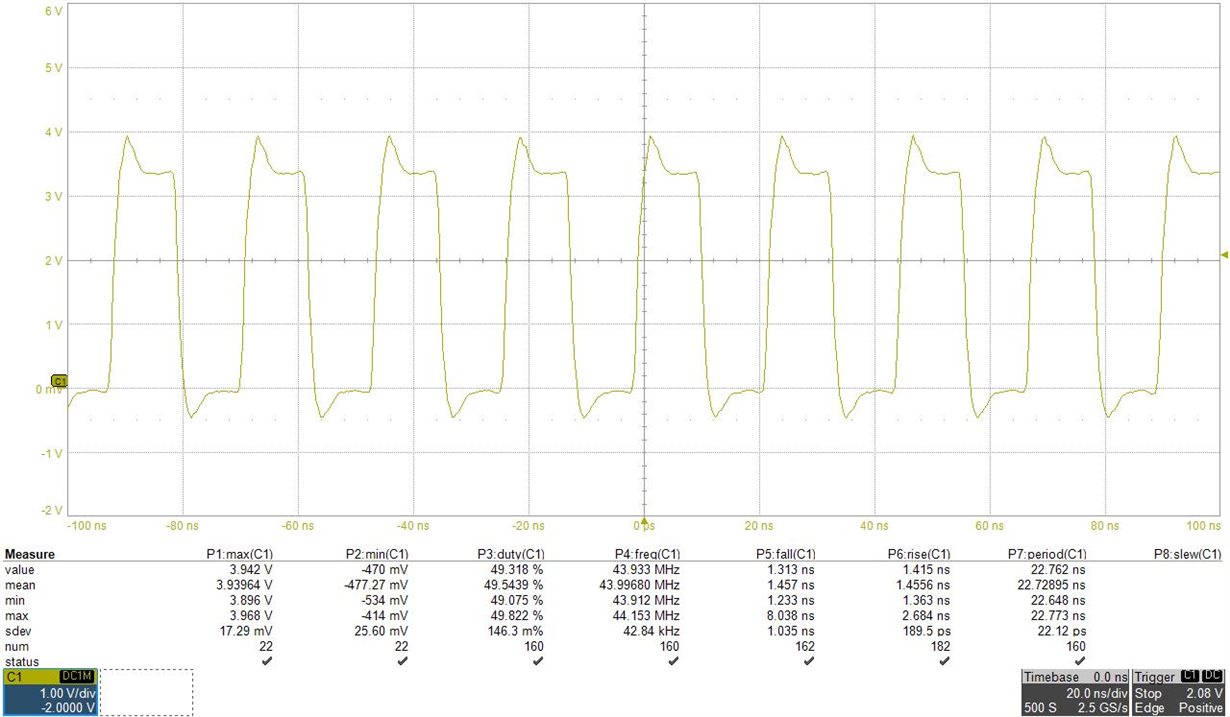

    I have forget to attach one more figure:
    Yellow: SD2_CLK (3.3V) from CPU measured at D39 pin 18

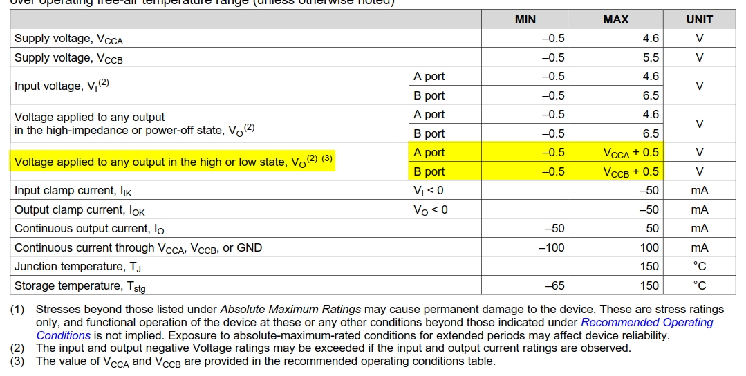

    Is it maybe possible that we have stressed the TXS0108 to much. According Spec there is only VCCA + 0.5V / VCCB + 0.5V allowed. And we have some peaks with 3.9V
    Because now our customer is also getting those errors.
    Thanks in advance.
    Juergen

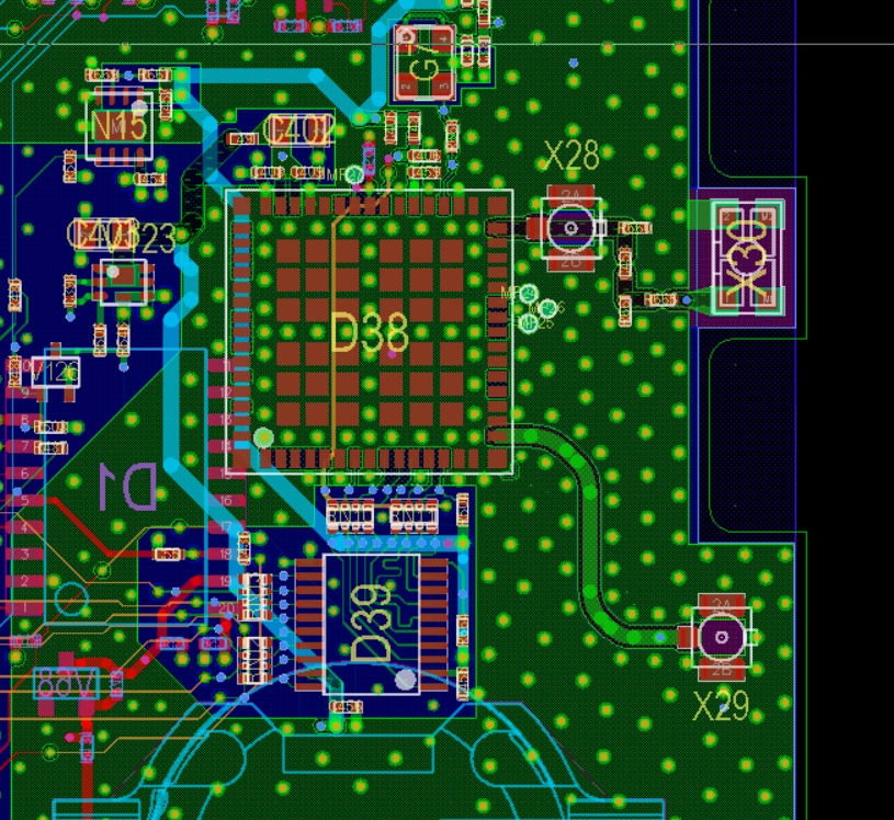

  • Hi Juergen,
    1) Are the blue dots on your layout vias? Or soldermask opened testpoints?
    2) From reading the TXS0108 datasheet, external pull-ups should not be required as the device has internal smart PU/PD resistors.
    3) From your layout, I see that there is no solid ground plane under the TXS0108. Having a solid plane minimizes inductance which is desirable for high speed signals. This also serves as a good thermal conductor and can act as a heat sink to keep thermal levels minimized.
    4) The lengths of the traces from the WL1807 to the TXS0108 could have been minimized if the TXS0108 is rotated 90 degrees counter clock wise. Also the traces that connect to WL1807's pins 6 and 7 are winding. The could possibly create a large current loop and noise along the path as well as EMI.
    BR,
    Seong
  • Hi Seong,
    1) These are testpoints / measurementpoints for easier  signal integrity measurements.
    2) I agree with you.
    3) Actually I only show you the first layer. Here a new figure with all layer shown:
    Layer 2 is GND, Layer 3 is signal, Layer 4 and 5 is VCC, Layer 6 is signal, Layer 7 is GND, Layer 8 is signal
    4) Could be...
