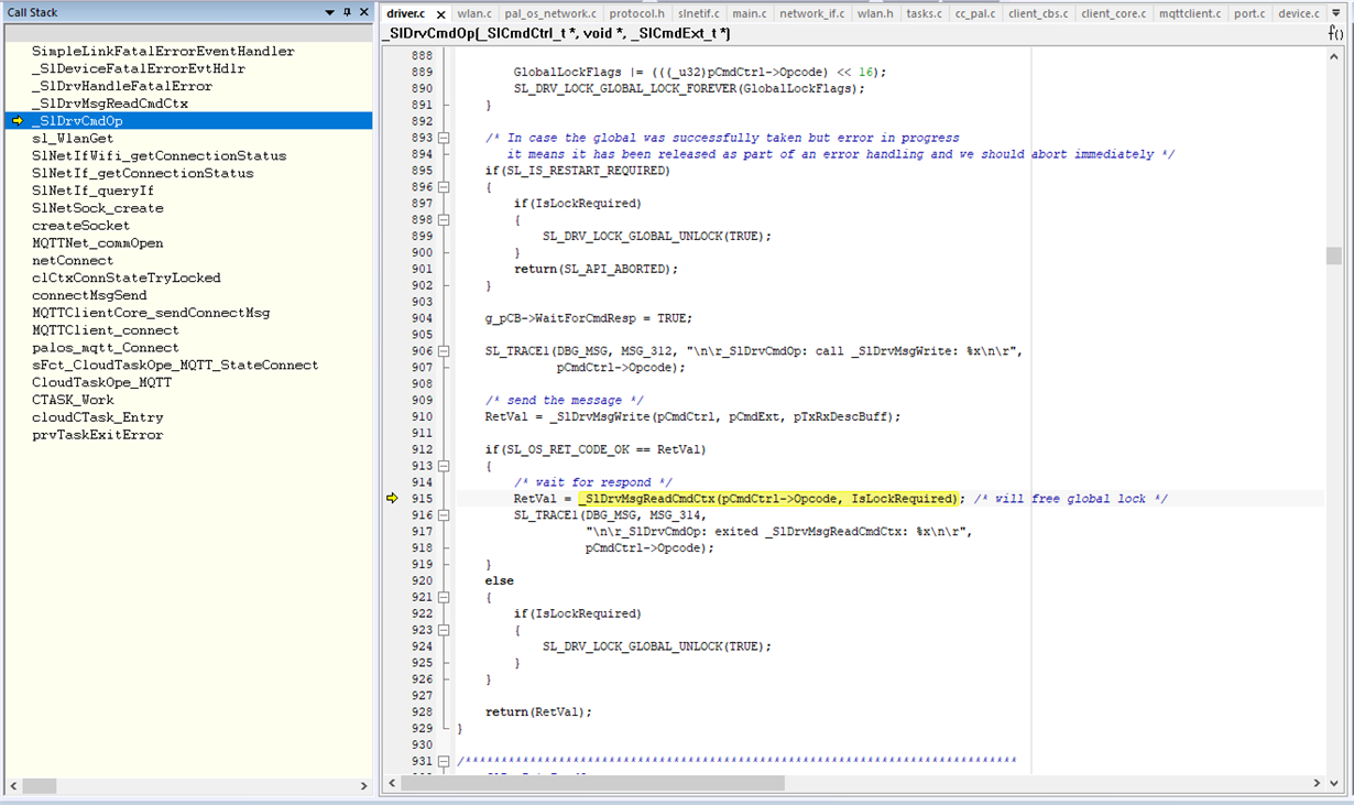

I am using STM32L4 microcontroller and the BOOSTXL-CC3135 WIFI module interfaced through SPI,
I have successfully ported the CC3135 driver that I found in the simplelink_sdk_wifi_plugin_2_40_00_22, and I used the DPL source files that I found under the simplelink_cc32xx_sdk_3_30_01_02\kernel\freertos\dpl SDK to interface the CC3135 module with FreeRTOS,
Note that in my STM32 application, I am using the FreeRTOS V10.0.1, and IAR embedded workbench(8.22.1)
As a result, I can successfully start the CC3135 module in STA mode, Connect to an access point, and use the MQTT library to publish and subscribe to topics.
I have a little strange behavior in my application, and it appears in this case:
  • The system Core Clock of the host is equal to 120 (and  my SPI frequency is equal to 15MHz)
  • and the Power Manage Policy is a Normal Policy (default and desired policy).
In fact, the behavior is random and can be summarized that the MQTT library does no longer works correctly, and that after a certain time I would get the following error message "[ERROR] - FATAL ERROR: No Cmd Ack detected [cmd opcode = 0x84b7] "
I have resolved the problem with different ways:
  1. When I use  System Core clock equal to 80 MHz, with the same SPI frequency (15 MHz)
  2. By putting a delay of 1 ms after each assertion of CS pin (and before transmission or a reception from SPI lines )
  3. By changing the Power manage Policy from SL_WLAN_NORMAL_POLICY to SL_WLAN_ALWAYS_ON_POLICY.
I am almost certain that my issue is not SPI or GPIOs configuration, I already visualized signals and they are OK.
I think that the CC3135 module was in a certain mode that does not wake up and received frame that I send from SPI, that's why maybe a delay between assertion CS and transmitting frame let the CC3135 wakes up from a low power mode.
So, my questions are :
  • Is there another host frequency requirement? apart from the frequency of SPI interface ? maybe it does support that my host is working with 120 MHz ? (note that I changed to 100 MHz and still not working)
  • When Using the SL_WLAN_NORMAL_POLICY , is there a minimum required time to wake up from the sleep mode ?
  • How can I configure the CC3135 module to works with a host that uses 120 MHz as a system frequency and 15MHz as SPI frequency, using a SL_WLAN_NORMAL_POLICY  power manage policy and without putting delay ?

  • Ghada,
    It looks like the NWP doesn't see you send the 0x84b7 command (DeviceSet()) command. Can you verify that this error code always occurs, and then find where in your code this command is getting called from?
    I would suggest continuing the debug there to understand what power modes your device is in right before calling this, and if you there is bad behavior occuring.
    Lastly, can you share your user.h file so i can verify your mapping?
    THanks,
    Vince
  • Hi Vincent,
    Yes, I think also that the NWP doesn't see my deviceSet command, this error code occurs very frequently.
    In fact, the DeviceSet function is called before connecting MQTT client to broker, and used as below:

    I have ignored this function call, as I am using mqtt in a non secured communication (no TLS), and unfortunately, the problem has just been created in another function: "sl_WlanGet", in fact, below the screenshot of my IAR when the problem occurs in the sl_WlanGet function (this function is called by the MQTT Library in the MQTTClient_connect procedure )
    and in this case, the error message is : "[ERROR] - FATAL ERROR: No Cmd Ack detected [cmd opcode = 0x8cb6] " and the 0x8CB6 represents the SL_OPCODE_WLAN_CFG_GET value.
    So I don't think that the error becomes from the use of the sl_DeviceSet function, neither sl_WlanGet. It seems that the NWP is not able to receive my command when my host is working with 120MHz and the NWP is in a Normal policy.

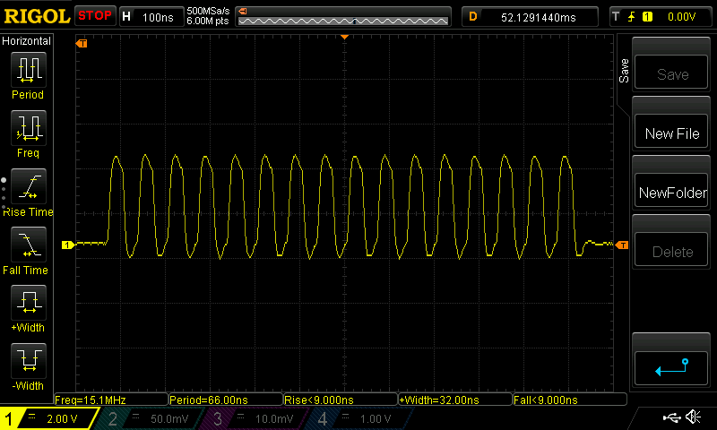

  • Ghada,
    This sounds like a clocking issue with your STM device. Can you verify you're SPI port is 20 MHz or lower going to our device?
    Vince
  • Hi Vincent,
    Thank you for your response,
    My SPI frequency is 15 MHz, I am using 120 MHz as a system Core clock and prescaler 8 for the SPI.
    Note that I have lowered the frequency until 3.75 MHz and the issue still occurs. and it disappears only with one of ways that I have described in the ticket description.
    Ghada
  • Ghada,
    Do you have a way of measuring this clk signal coming from the pin to verify?
    BR,
    Vince
  • Hi Vincent,
    You will find attached the clk signal measured from the BOOSXL_CC3135.
    Ghada
