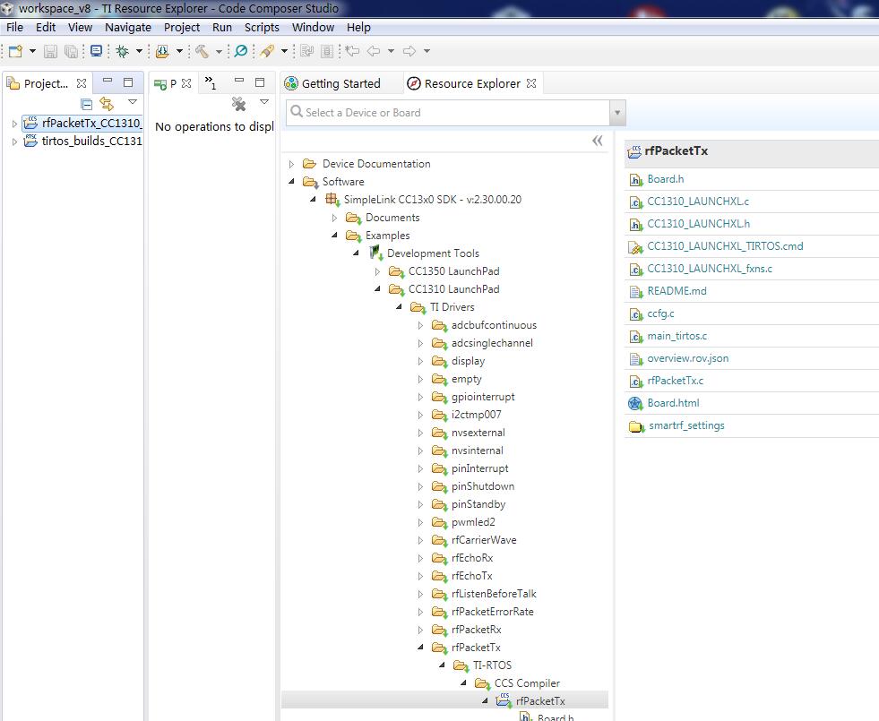

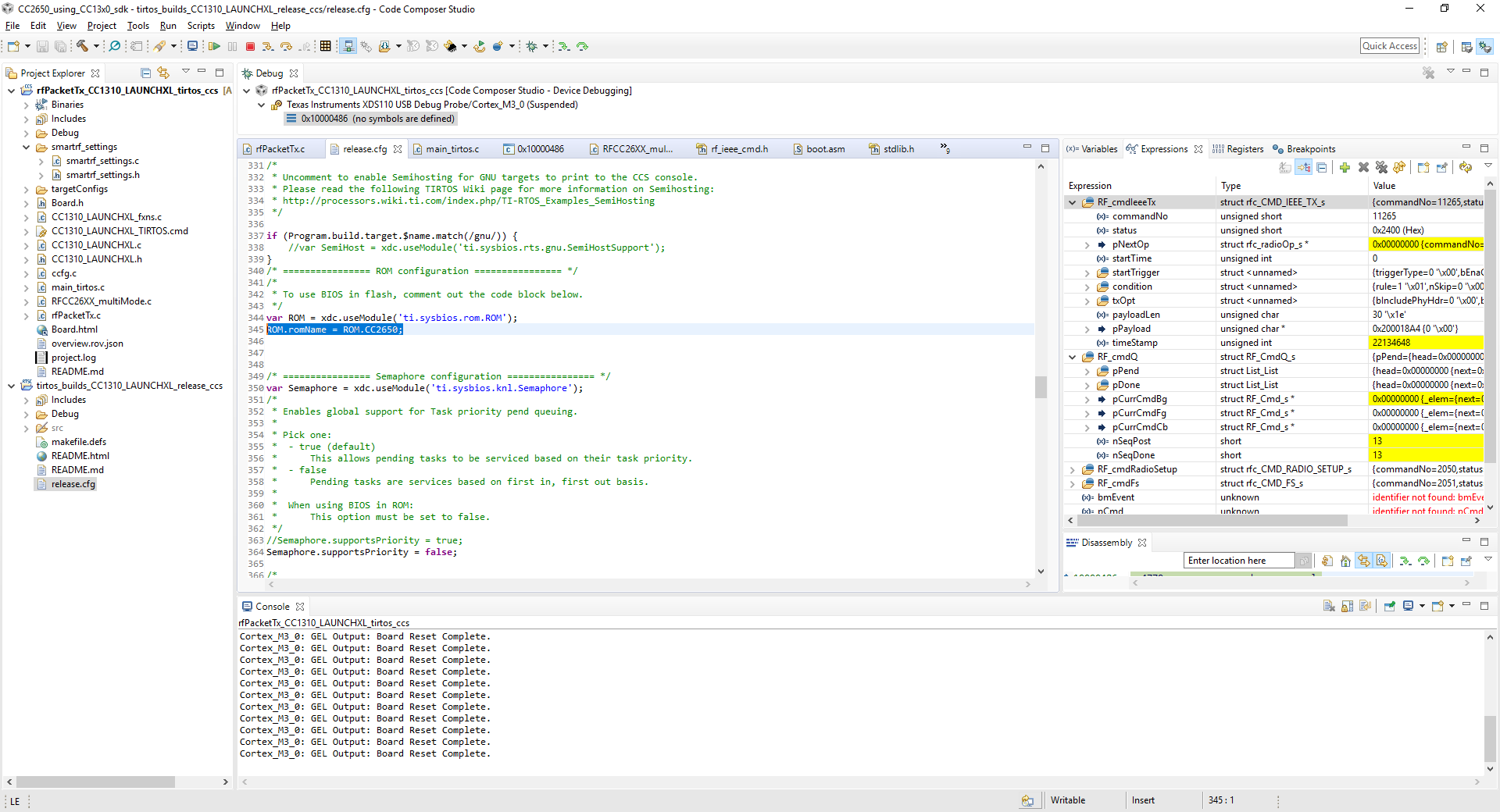

I want to use the demo code (simplelink_cc13x0_sdk_2_30_00_20/examples/rtos/CC1350STK/drivers/empty) run in CC2650.

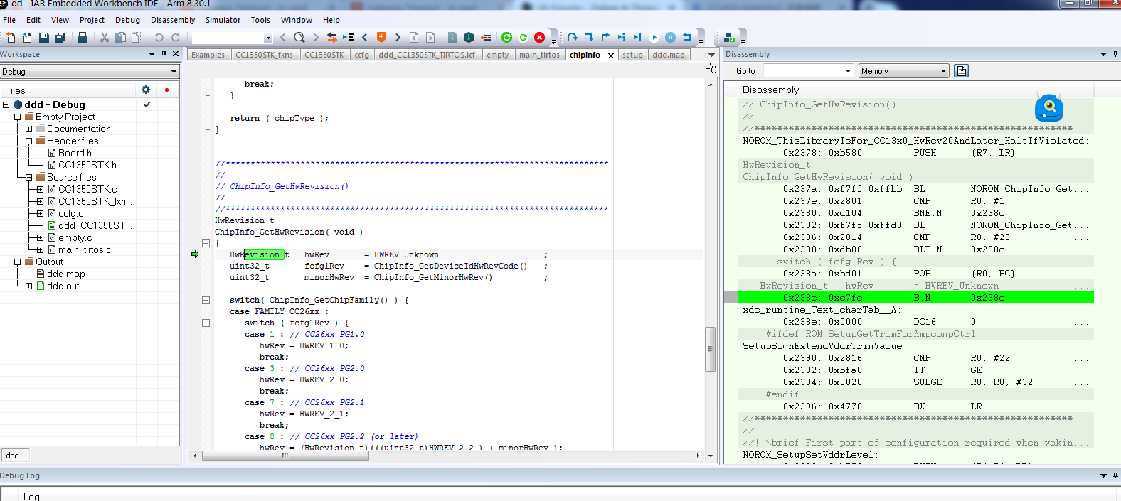

I modify the IAR/options/General Options/DEVICE :TexasInstruments CC2650F128 ,

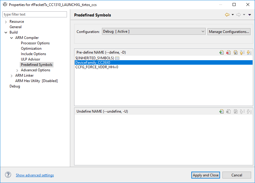

I modify the IAR/options/C/C+= COMpiler/Extra Options :"-DDeviceFamily_CC13X0 "to"-DDeviceFamily_CC26X0"
I move the "setup.h/chipinfo.h"form tirtos_cc13xx_cc26xx_2_21_01_08 to simplelink_cc13x0_sdk_2_30_00_20.

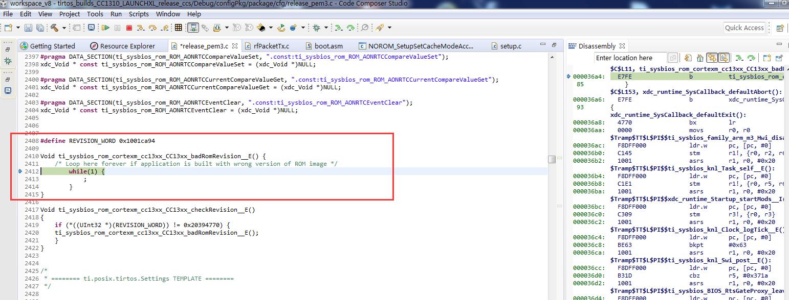

When i debug ,IAR can't run to main, it can't check the mcu is cc2650F128.
How can i modify the system parameter to recognize the chip for CC2650 ,let it run to main?

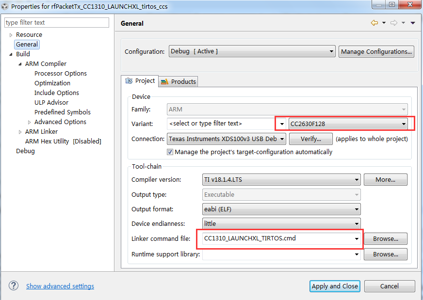

  • The following described the steps necessary to run the CC2650LP using the simplelink_cc13x0_sdk_2_30_00_20. I used the rfPacketTX example as a starting point:
    In addition, you need to copy the attached zip file to C:\ti\simplelink_cc13x0_sdk_2_30_00_20\source and extract to “ti\”.
    I have also attached the modified rfPacketTX.c and the settings files I used.
    1321.ti.zip

  • HI,Siri. i'm back,i'll continue to explore this application. It still has problems, I am still analyzing the problem.
    I used IRA to debug CC26X0 in the past . So I spent one day familiar with the CCS Development Environment.
    I want to say the new CCS V8 is batter than old Version,i used the CCS3 a few years ago .
    The environment I use is:  CCS Development Environment: Code Composer Studio Version: 8.3.0.00009
                                             SDK: simplelink_cc13x0_sdk_2_30_00_20
    I use the tirtos_cc13xx_cc26xx_2_21_00_06/rfPacketTx_CC2650DK_7ID_TI test this Development Environment.
    The Development Environment system works is ok.The cc2650 mcu control LED work is ok.
    I strictly follow your instructions to modify the configuration and related files.

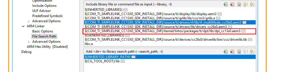

    The first problem is about the third picture you provided .
    Do we need repair ${COM_TI_SIMPLELINK_CC13X0_SDK_INSTALL_DIR}/kernel/tirtos/packages/ti/dpl/lib/dpl_cc13x0.aem3 to
    ${COM_TI_SIMPLELINK_CC13X0_SDK_INSTALL_DIR}/kernel/tirtos/packages/ti/dpl/lib/dpl_cc26x0.aem3 ?
    This point i'm not sure.
    I test repair it to dpl_cc26x0.aem3 ,i have'n discover any difference. So i follow your instruction keep on use dpl_cc13x0.aem3.
    The new problem is When i debug ,CCS can't run to main too. It's dead again.
    The code run to ti_sysbios_rom_cortexm_cc13xx_CC13xx_checkRevision__E()……Why?I can't understand.

    I have changed the screenshot with the File Search Paths
    I have added a screenshot showing changes that must be done in release.cfg
    Hopefully this will you get it up and running.

    I have tested the cc2630(5X5) run in this SDK,It's OK.
    First it need repair CC1310_LAUNCHXL.h and board.h……,then it  need repair the key of settings as described below:
