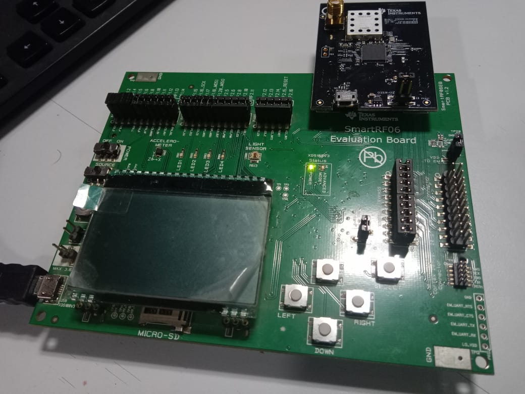

Hello
what are the changes required in zigbee 3.0 gateway to use cc2538 znp with UART interface?
any documentation for that.
  • Part Number: CC2538
    I am using cc2538-cc2592emk as znp with UART interface with Raspberry pi 3 and zigbee 3.0 gateway.
    But its not working.
    when I run the ZigbeeHAgw it does not starts.
    PFA for  gateway logs

  • I have connected to z-TOOL , as shown above and Z-tool connection ststus.
  • Since it works with ZTool, I suggest you to connect it to Zigbee 3.0 Gateway and debug with IAR to see what is missed.

  • yeah we have used the cross-compiler tool chain and built the gateway arm binaries
  • Do you have CC2531EMK or LAUNCHXL-CC26x2R1 to test this with prebuilt ZNP image and see if it works first?
  • We have LAUNCHXL-CC26x2R1 (Both Revision C and Revision E) which one shall I test with ? There are pre built znp.hex images available in the gateway folder should i use that to test ?
  • LAUNCHXL-CC26x2R1 Rev C is working
  • If you use prebuilt CC2538_GW_ZNP_SRF06+EM_UART.hex to test it, does it work?
  • If we use prebuilt CC2538_GW_ZNP_SRF06+EM_UART.hex to test it, It does not work ?
  • Do you mean you already test with prebuilt CC2538_GW_ZNP_SRF06+EM_UART.hex and it doesn't work?
  • yes , i have tested once again now it does not work with prebuilt CC2538_GW_ZNP_SRF06+EM_UART.hex
    Strange thing is that  prebuilt CC2538_GW_ZNP_SRF06+EM_UART.hex does not work with Z-tool
  • Are you using XDS100v3 thought USB for communication or UART pins directly?
  • First of all , m really sorry to trouble you all.
    when I test prebuilt CC2538_GW_ZNP_SRF06+EM_UART.hex I have used XDS100v3 through USB for communication with Enable UART over XDS jumper cponnected .And it does not work with Z-tool
    when I test my ZNP over UART code, I have used XDS100v3 through USB as well as UART pins directly for communication.
    and it was working with XDS100v3 through USB with z-tool.
    and it was not working with UART pins directly from smart RF board uart header (P412).After troubleshooting i found that GND pin of P412 header was not connected to GND of smart RF board.later I connected GND from different header and it started working.
  • So, does everything work now?
  • with my code , YES everything works now.
