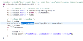

I test the spi performance using code as below:

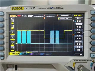

I use led on and off to cover SPI_transfer().
I test led pin and spi clock pin, the waveform is as below:
In the picture, the yellow waveform is led pin (low when led on), the blue waveform is spi clock.
From the picture, I find there is a 7us delay between led on and spi clock starts. Also a 5us delay between led off and spi clock stops.
Now my application is sensitive to this 7us delay and 5us delay, and I need to make them short as soon as possible (Of course the delay can not be 0 to satisfy SPI timing sequence).
This delay is too long for my application.
