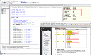

CC2530: Testing 32-bit shift, add, subtract, multiply and divide operations on IAR platform is very time consuming. Is it normal?
Part Number: CC2530
As mentioned above, I create a new project on IAR EW8051 9.10.1, and then use oscilloscope to measure the time computation of 32-bit data (unsigned long) operations.
However, it was found that there are quite serious time-consuming problems, such as:
The 31-bit left/right shift operation takes about 60us, and the division takes 123us, and so on.
What seems to be the problem?
Thanks a lot for your attention!
Here is the code:
Test time elapsed time of 32-bit operetion.

        /* Tests:
        1--7.5us. 5--14.6us.  10--23.6us.  13--29.0us.  16--34.4us.
        19--39.6us.  24--48.8us.  29--57.6us.  31--61.2us.     */
        unsigned long C = A << 31;
        LED1 = 0;
        LED2 = 1;
        /* Tests:
        1--7.6us.  5--15us.  10--24.4us.  13--29.8us.  16--35.4us.
        19--41.2us.  24--50.4us.  29--59.6us.   31--63.2us.    */
        unsigned long D = A >> 31;
        LED2 = 0;
        LED3 = 1;
        unsigned long E = A + B; //Test: 8.3us
        LED3 = 0;
        LED4 = 1;
        unsigned long F = A - B; //Test: 8.9us
        LED4 = 0;
        LED5 = 1;
        unsigned long H = A * B; //Test: 18.6us
        LED5 = 0;
        LED6 = 1;
        unsigned long I = A / B; //Test: 123us
        LED6 = 0;
    return 0;
Some environment settings are as follows:
