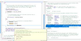

    Also I found another bug in the LED driver.
    Parameter "uint16_t togglePeriod" in the LED_Object structure should be uint32_t. Otherwise long blinking periods don't work, because number of ticks doesn't fit into uint16_t.

    Also let me show what I meant by the bug in the LED driver, maybe it was not clear.
    In fact, the "togglePeriod" is not in "ms" units, it is in "tick" units.
    And the msToTicks() function returns uint32_t, although the "togglePeriod" is uint16_t.
    It seems like a bug.
  • Thanks for clarifying, a second ticket has been filed so that the responsible Team can handle this issue.  You can modify the TI Driver files by copying the LED.c module directly into your project and making changes to source/ti/drivers/apps/LED.h
    Ryan
