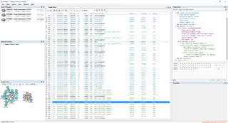

  • So after hard reset and configuration restore, the system is now sending responses to all connected devices. But the routing devices appear not to be happy as they are continuing with the requests. This is a filtered view on one of them:
    Here the MD Response is sent to 0xDB79 through 0x1357. The message is getting acknowledged.
    One second later 0xDB79 is sending the request again:
    Is there any sense behind that, anything we can do on gateway side, or is this a bug of the routing device?

  • Hi Peter,
    Packet 3511 is a Match Descriptor Response to 0xDB79, packet 3582 is the re-broadcast of the Match Descriptor Request from 0xCC39.  0xCC39 appears to be causing a lot of network traffic, as the coordinator is constantly requesting a route to 0xCC39.  0xCC39 constantly repeats Match Descriptor Requests even though the coordinator responds with a Match Descriptor Responses, possibly since the 0xCC39 indicates that is does not have a route available to the coordinator.
