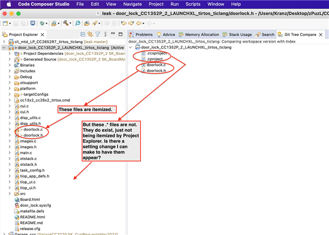

By default the project explorer filters out files that start with .*
You can change this behaviour by clicking on the filter icon at the top of Project Explorer and then uncheck the ".* resources" filter that is enabled under pre-set filters.
Once you do that the .project... files will be visible.
