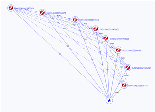

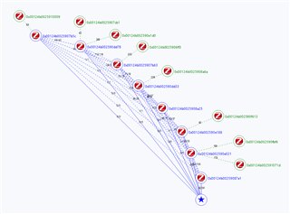

Good  morning.
We are testing some topology architectures based on a CC2652P ZNP coordinator connected to a straight line of devices which are a mix of custom routers and custom end-devices, each one with 8 endpoints of type "Smart Plug", intended to be polled for their metering/onOff values and to be reached by onOff commands.
Our application would need some lines of at least 30 devices, spaced out around 20 meters, minimizing the number of coordinators. Any number of devices below those numbers would not justify the use of Zigbee instead of a traditional big Wi-Fi network.
The firmwares are variants of zr_genericapp and zed_genericapp, with working endpoints, clusters and attributes added manually.
1 - We first tried to put a series of 20 routers in a straight line, distantiated about 20/30 meter
The results were not well promising: the in-field pairing of the devices used to work at the first attempt until the 9th 10th node, then the interview used to fail gradually until it needed 6,7 attempts to finally finish with success. Then, polling the devices goes well for the first nodes, then resulted in timeout when polling the 12th/13th device and above. So we can deduct that the maximum number of hops is something around 10 (as Ryan told me some times ago). Is it possible to increment this number in any way? I tried to tune some knobs it default/ti_zstack_config.h and Stack/nwk_globals.h without differences:

2 - We limited the number of routers to 8, obtaining the following topology:
I then created a script to poll the devices' endpoints (using Zigbee2Mqtt API's) and measure elapsed times, first polling only a single endpoint (2 clusters, metering and onoff) per device and then all 8 endpoints (smart plug) for each of the 8 devices. No timeout have occurred. Here are the logs:
Field test, polling 1 endpoint per device, Routers only
Device: 0x00124b002590e188 [Router],            Time elapsed: 153.884ms, Average per attribute : 76.942ms
Device: 0x00124b0025907b5c [Router],            Time elapsed: 208.8629ms, Average per attribute : 104.43145ms
Device: 0x00124b0025908a25 [Router],            Time elapsed: 219.8165ms, Average per attribute : 109.90825ms
Device: 0x00124b0025907b63 [Router],            Time elapsed: 238.5847ms, Average per attribute : 119.29235ms
Device: 0x00124b00259087a1 [Router],            Time elapsed: 118.6589ms, Average per attribute : 59.32945ms
Device: 0x00124b002590dd78 [Router],            Time elapsed: 185.6975ms, Average per attribute : 92.84875ms
Device: 0x00124b002590e021 [Router],            Time elapsed: 146.0539ms, Average per attribute : 73.02695ms
Device: 0x00124b002590dd33 [Router],            Time elapsed: 184.1201ms, Average per attribute : 92.06005ms
Full poll time: 1.4556785s

3 - We bound 8 end devices along the line, obtaining the following topology with 16 devices:
Now i have run the script again, no timeout have occurred, but the end-devices have presented huge delays, here are the logs:
Field test, polling 1 endpoint per device, 8 Routers + 8 EndDevices
Device: 0x00124b0025908a25 [Router],            Time elapsed: 176.9852ms, Average per attribute : 88.4926ms
Device: 0x00124b002590fbf6 [EndDevice],         Time elapsed: 222.6546ms, Average per attribute : 111.3273ms
Device: 0x00124b0025908a6a [EndDevice],         Time elapsed: 1.0652301s, Average per attribute : 532.61505ms
Device: 0x00124b0025907b5c [Router],            Time elapsed: 198.8744ms, Average per attribute : 99.4372ms
Device: 0x00124b0025907b63 [Router],            Time elapsed: 197.2419ms, Average per attribute : 98.62095ms
Device: 0x00124b002590dd78 [Router],            Time elapsed: 167.8257ms, Average per attribute : 83.91285ms
Device: 0x00124b002591071d [EndDevice],         Time elapsed: 1.431613s, Average per attribute : 715.8065ms
Device: 0x00124b0025910009 [EndDevice],         Time elapsed: 5.8469776s, Average per attribute : 2.9234888s
Device: 0x00124b002590f613 [EndDevice],         Time elapsed: 2.9179497s, Average per attribute : 1.45897485s
Device: 0x00124b00259087a1 [Router],            Time elapsed: 103.736ms, Average per attribute : 51.868ms
Device: 0x00124b002590dd33 [Router],            Time elapsed: 177.8675ms, Average per attribute : 88.93375ms
Device: 0x00124b002590e1d0 [EndDevice],         Time elapsed: 4.1672753s, Average per attribute : 2.08363765s
Device: 0x00124b0025906ff3 [EndDevice],         Time elapsed: 5.6209016s, Average per attribute : 2.8104508s
Device: 0x00124b002590e188 [Router],            Time elapsed: 120.3848ms, Average per attribute : 60.1924ms
Device: 0x00124b002590e021 [Router],            Time elapsed: 126.3897ms, Average per attribute : 63.19485ms
Device: 0x00124b0025907cb1 [EndDevice],         Time elapsed: 4.1024619s, Average per attribute : 2.05123095s
Full poll time: 26.644369s
