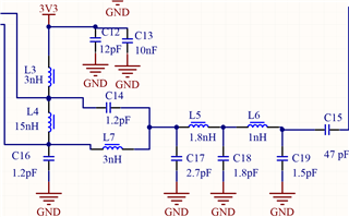

Hi TI?
I have differents designs for CC2652P and CC1352P.
Allways the same shematic in the PA output (attahed shematic for power amplifier output 2.4GHz). Same as LAUNCHPADCC1352P2.
The designs for CC1352P working perfectly, but the  designs for CC2652P has problems with the power amplifier.
The circuit attached is ok for CC2652p  power amplifier output 2.4GHz?
