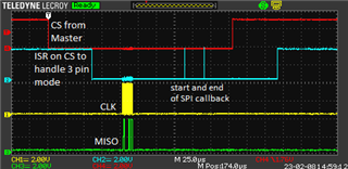

    Description:
    * ISR on CS from SPI to handle 3 pin mode internally
    * SPI in callback mode running on RTOS thread
  • ch4 - CS from SPI master to signal start and stop of communication
    ch2 - workaround to handle 3 pin mode and reload SPI after every byte (CS is asserted when master signals start and also after every frame)
    ch1 - clk
    ch3 - MISO
    Here is the example of ~60us delay on HWI and SWI.
    Between ch4 and ch2 we can observe around 60us constant delay. Setting og ch 2 is done from the hwi. Ideally this latency shall we couple of us
    between ch1 and spikes on ch2 we can observe a time for the SPI callback to fire (also 60us). The spikes on CH2 are only to show start and end of processing time in the callback.
    The goal would be to minimize a latency on hwi and sw and with that reduce time needed to transfer 1byte over SPI.
    How can this be achieved?
  • Hi Ivan,
    It would appear that you have already done an adequate job of resourcing the spislave example and the SPI TI driver already uses the underlying SPICC26X2DMA.h layer.  Your master device could send multiple bytes consecutively which could then all be processed by the slave device without need for additional delays.  Otherwise you would need to forego the RTOS and use DriverLib directly which would be much more complicated to develop.
    Ryan
