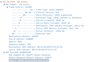

Environment: I have a cc2530 sensor and coordinator. When the sensor is at a certain distance from the coordinator (a critical point where normal communication cannot be achieved), the sensor's rejoin process is triggered, and the coordinator also replies to the rejoin resp, but then znp pushes the MT_ ZDO_ LEAVE_ IND message, but no corresponding sensor device

    2.Rejoin Response it seems correct

  • It's strange that there is no ZDO leave or nwk leave packets in your sniffer log but you see MT_ZDO_LEAVE_IND from your MT command recceiver.
  • What is your CC2530 sensor firmware?  Is it from Z-Stack 3.0.2 and what specific project is referenced?  Have you reviewed the known issues and fixes?
    I can observe a Leave in the sniffer log which comes from 0xFA9D, IEEE address 94:DE:B8:FF:FE:41:E3:34, and cannot determine if this is related.  There are several packets missing from the log as indicated by ACKs without an original message and missing MAC Sequence increments.  0x8F83 (00:12:4B:00:23:59:CC:56) broadcasts an Orphan Notification after none of its Data Requests are ACKed by the ZC after the Rejoin Response.  Both devices may still be too far for steady communication.  You could try hard resetting the sensor device or perform a soft reset or restart the rejoin process if you are able to change the sensor software.
