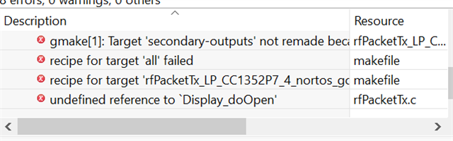

  • The following header file is included : #include <ti/display/Display.h>
    Re-used the code snippet from the tutorial:
    Display_Handle display;
    display = Display_open(Display_Type_HOST, NULL);
    Compilation throws errors. What else should I check?

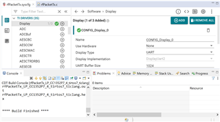

  • Did you add Display module from within the SysConfig file's TI DRIVERS options? I could recreate your project's behavior by leaving this out, but re-building with a Display module resolved the issue and completed the build.
    Ryan

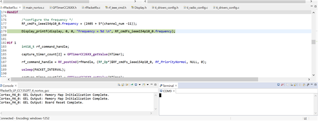

    Here is the initialisation code:
    Display_Params    params;
    //display = Display_open(Display_Type_HOST, NULL);
    display = Display_open(Display_Type_UART, &params);
    Nothing gets printed on the CCS console(display type as HOST in sysconfig).
    Neither on CCS Terminal @ 115200 baud( when display type is UART in sysconfig).
    Anything else to cross check?
    Karthik
  • Did you change the SysConfig -> UART2 module's "Use Hardware" feature from "None" to "XDS110 UART"?  That worked for my system using the default LaunchPad's XDS110 backchannel UART connection.
    Note that I am using a different LaunchPad version (one with only 2.4 GHz) but still the rfPacketTx example so the concept applies.
    Ryan
  • This worked!
