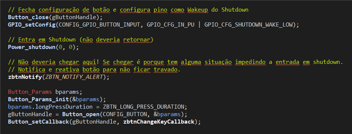

  • I checked my code to enter shutdown mode and I am using Power_shutdown(0, 0). Its documentation states that this routine should respect any constraint set by the stack or any other driver that uses power management. So I don't think I am corrupting NVS going to shutdown, right? My code is the following:
    Battery tension barely falls below 3V during operation, never below 2.9V in my tests. I will implement low voltage detection, but I don't think this is a problem now.
    Well, I will try to identify if my problem is caused by a factory new reset or NVS corruption. For factory new reset, I will try to find where it could be triggered and put some code to notify me if that code path is executed. And for NVS corruption, I think that I need to examine NVS content after the event happened. Do you have any other suggestions about how I can identify NVS corruption?
