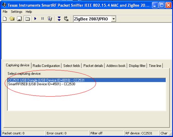

  • Leila,
    Yes you need a separate HW like CC2530EM+SRF05EB or CC2531EM to sniff packets.
    - Cetri
  • Good guess. I am powering my boards from the same PC as I am using the Packet sniffer. so now you are saying that if I want to sniff packets I should only connect a board that is meant to use for sniffing only  to my PC, Is that right?
    I will try again to see how things go with a different board.
    Thanks for the help.
    Leila
  • Leila,
    You can connect more than one device to your PC and select one among them as a sniffer. Please see below screen capture:
