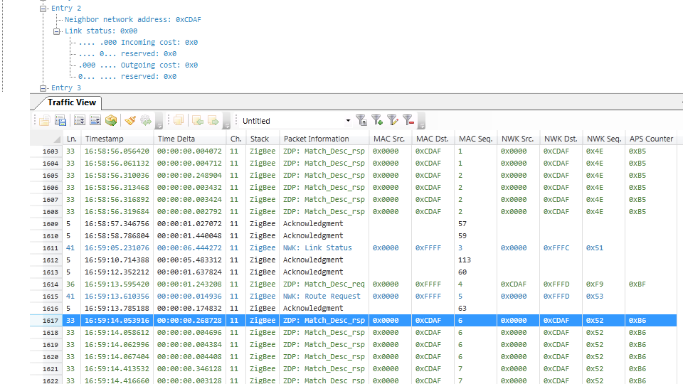

I am running 2.5 stack and my system looks like this: I am running exact same configuration as "SensorDemo" as I have requirement to collect data from multiple nodes and aggregate in central device.
- Router "A" which also acts as end point, connects to Gateway through router "B".
- On the startup, system runs fine. It ran for almost 12 hours. After that A stops responding.
- On the network analyzer I find that, A is sending match descriptor request to Gateway (Through its router B). Gateway who is also co-ordinator,  sends rsp directly to "A".
- As A is not directly in range of Gateway/co-ordinator, Probably A never gets rsp sent and comes back online.
Does this sound like an error? I also observed the link status for co-ordinator and clearly it has entry for "A", but all 0 which I assume means, not direct link.
Attached the log. A = 0xCDAF Network address
  • Adding some more data:
    Basically what I see is "A" has "incoming link cost to "B" = 7. Outgoing cost= 0. We do not see any "route reply" from A to B(probably outgoing from A is not working at all!). Right at the time of failure. Is this the reason? Given that "match_desc" requests are coming to co-ordinator, can I assume only the receive functionality of A has issues and most likely at PHY later? Can I rule out any NWK related issues at this point?
    BTW, after resetting A- We see everything working fine- as in "route reply to B which sets new incoming and outgoing values" and everything sets up fine.
