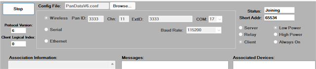

-DZDAPP_CONFIG_PAN_ID=0x043B
A Client (Device Emulator) joins a Coordinator successfully
If I set
-DZDAPP_CONFIG_PAN_ID=0xFFFF
A Client Can't join a Coordinator

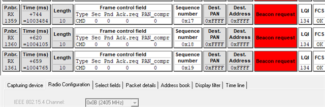

in the sniffer log show
  • Hi oanh,
    Make sure that you are erasing all memory or factory resetting the device to clear the previous Zigbee information in NV memory before attempting to start a new Zigbee network with a different Pan ID.  You will need to re-commission the ZC before its Zigbee network is formed and it responds to Beacon Requests.
    Once a Coordinator starts a network, Zigbee configurations such as channel, pan ID, and extended pan ID are statically set.  A joining device certainly can't determine what Zigbee configurations the ZC should use instead.  Any changes to the network configurations should be determined on the ZC locally before the Zigbee network is formed.
