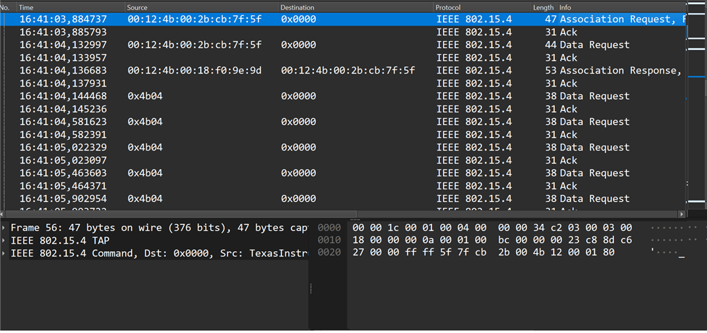

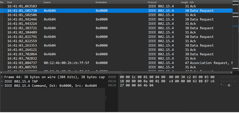

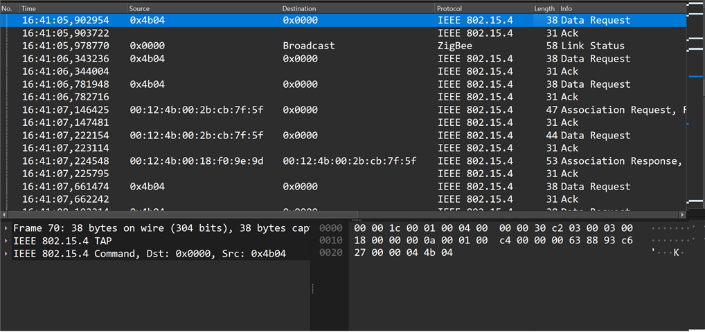

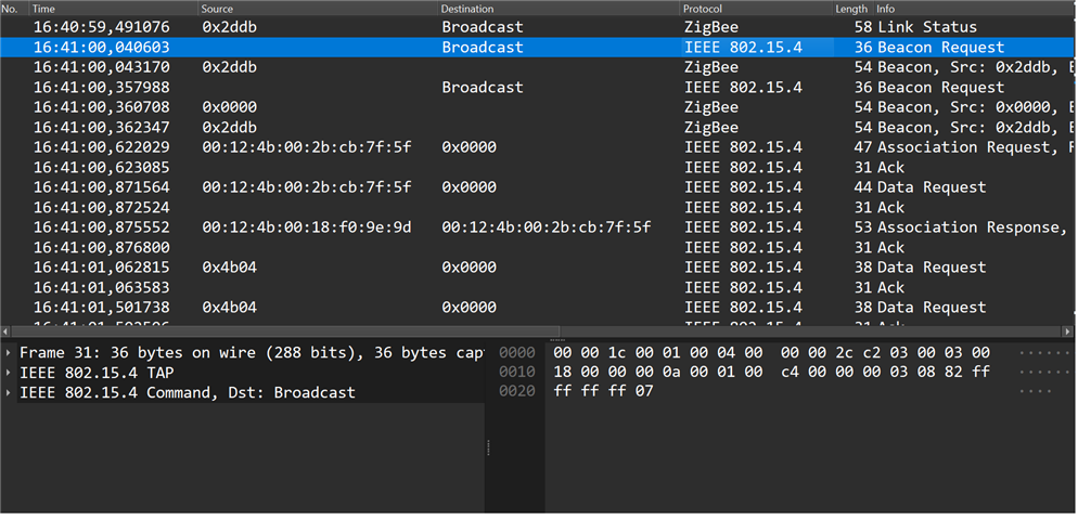

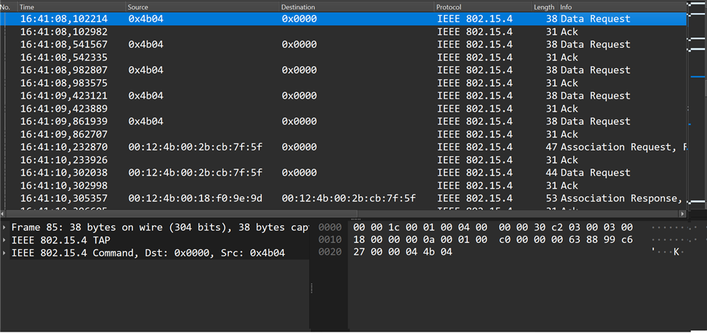

We develop an application based on ZigBee communication. Our device (cc2652r7, end device role) is supposed to be connected to a coordinator. The coordinator is old enough (we don't have an access to it's source code) and on network layer (NWK) doesn't use network layer sequrity. Our device (it uses simplelink_cc13xx_cc26xx_sdk_8_30_01_01) can't be connected to coordinator's network (It waits for security key). We understand that we can't disable security for this Z-stack version, but we still need some solution to have an opportunity to be connected to the coordinator. We want to use TI solution in our further development. Maybe there are an option how to resolve this problem. Will be appritiate for a response and any thoughts about it. Take a look for WireShark log, when we try to connect the end device to the coordinator. Thank you!
