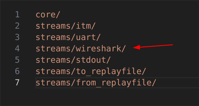

  1. Remove the Wireshark dependency: In the requirements.txt file (located in the tilogger root folder), I had to remove the line for the Wireshark module, as it is not compatible with Linux.

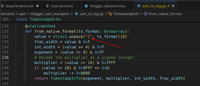

  2. Modify the UART script: I changed a line in the file tiutils/streams/uart/tilogger_uart_transport/uart_to_log.py.
    • From:
      value = struct.unpack("L", ts_format)[0]
    • To:
      value = struct.unpack("I", ts_format)[0]
Reason for the code change:
On Windows, the format character 'L' is interpreted as a 4-byte unsigned long and works as expected. However, on 64-bit Linux, it is treated as an 8-byte value, which causes an error while decoding the log messages from the UART. Changing it to 'I' ensures it is consistently handled as a 4-byte unsigned integer.
