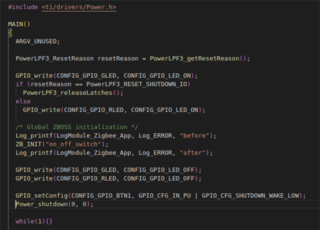

I am developing a Zigbee device using CC2350R5 and I'm facing a boot issue.
My device normally stays in shutdown mode and wakes up via a button press. While this process works most of the time, some devices frequently freeze during the boot sequence and require a hard reset to recover.
I have isolated the issue to the Z-Boss stack initialization, where the code hangs. This situation appears to be identical to the one described in a previous post here in the forum (Post: "The initialization froze after the restart")

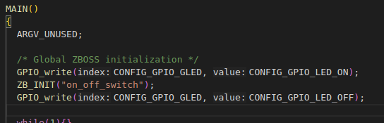

I can reliably reproduce the problem with a minimally modified on/off zigbee switch example. The bug often appears within seconds just by rapidly pressing the wake-up button. I was also able to trigger the freeze during a normal debug session (by repeatedly restarting the firmware using the reset button on the IDE), which indicates the issue is not exclusive to waking from shutdown.
During a freeze in the debugger, I captured the call stack, and it's stuck in the exact same function mentioned in the referenced post. Please see the image below:
And below, my example based o nthe on/off switch example, which can be used to reproduce the bug. Simply keep pressing the button until the green LED stays ON indicating the ZBoss init function did not return, and the device no longer reboots.
MAIN()
ARGV_UNUSED;
PowerLPF3_ResetReason resetReason = PowerLPF3_getResetReason();
GPIO_write(CONFIG_GPIO_GLED, CONFIG_GPIO_LED_ON);
if (resetReason == PowerLPF3_RESET_SHUTDOWN_IO)
PowerLPF3_releaseLatches();
else
GPIO_write(CONFIG_GPIO_RLED, CONFIG_GPIO_LED_ON);
/* Global ZBOSS initialization */
Log_printf(LogModule_Zigbee_App, Log_ERROR, "before");
ZB_INIT("on_off_switch");
Log_printf(LogModule_Zigbee_App, Log_ERROR, "after");
GPIO_write(CONFIG_GPIO_GLED, CONFIG_GPIO_LED_OFF);
GPIO_write(CONFIG_GPIO_RLED, CONFIG_GPIO_LED_OFF);
GPIO_setConfig(CONFIG_GPIO_BTN1, GPIO_CFG_IN_PU | GPIO_CFG_SHUTDOWN_WAKE_LOW);
Power_shutdown(0, 0);
while(1){}

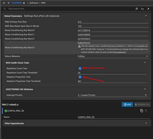

    I don't know what causes it, but certanly the problem is with randon noise capture and RNG Health Check Tests. A workaround that eliminated the problem completely, even in my minimal example, was to disabled RNG Heath Test in SysConfig:
    After disabling these two checks, I couldn't reproduce the problem even after clicking many times for many minutes in my minimal example. I know it is not a good solution, so I will try your suggestions.

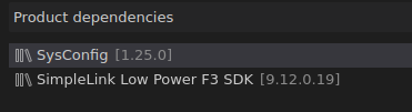

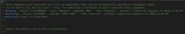

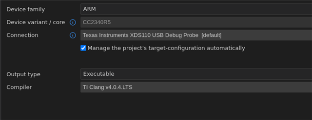

  • I updated all my tools, as listed below:
    CCS v20.3.1.5__1.9.1
    TI Arm CLANG v4.0.4
    Simplelink F3 v9.12.0.19
    SysConfig v1.25.0
    Then tried your suggestions by putting Power TI Driver PowerLPF3_getResetReason/PowerLPF3_releaseLatches functions in main() and disabling LTO., but got the same behaviour.
    Then I did a really minimal example, removed all the shutdown code and just turned LED ON before calling ZB_INIT and after it returns, turn LED OFF and enter in a while(1){}.
    Using this code, I tried to trigger the bug by resetting the board using the reset button on my programmer (a cc1352 LaunchPad). After some time, the green LED stayed ON, indicating a lock inside ZB_INIT.
    Then, I tried to trigger the bug by just resetting the device from the IDE (using shortcut ctrl+shift+R to reset, then F5 to run), in order to minimize physical interference. After some time I could trigger the bug again and as I was in the debugger, I could see the call stack.

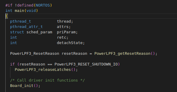

  • Hi Tiago,
    Thank you for providing all of this information.  You could copy simplelink_lowpower_f3_sdk_9_12_00_19\source\ti\drivers\rng\RNGLPF3RF.c into your local workspace directory to further debug RNG_getRandomBits -> RNGLPF3RF_getValidatedNumber, nevertheless I have found an internal bug ticket similar to the behavior you've described and will further inquire internally.
    Does an extra SW reset with PMCTLResetSystem after PowerLPF3_releaseLatches (i.e. only reset during wakeup from shutdown) help alleviate the behavior?  This is as a test, not a recommended workaround.

    Using the default CC2340R5 on/off switch, my changes are as follows.  First in ti_f3_main.c:
    int main(void)
      pthread_t           thread;
      pthread_attr_t      attrs;
      struct sched_param  priParam;
      int                 retc;
      int                 detachState;

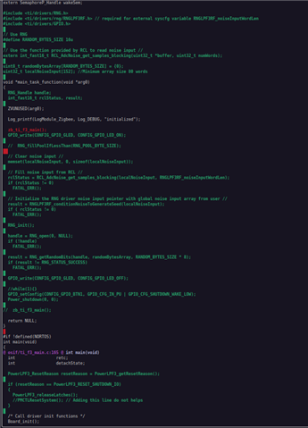

    Apologies for the delay in my response. I have spent some time investigating this issue further and have some important updates.
    Here are my findings:
    • I tried adding an extra software reset (PMCTLResetSystem() after PowerLPF3_releaseLatches()) as you suggested, but it did not help.
    • By copying RNGLPF3RF.c into my project, I've successfully isolated the problem to be independent of the Z-Boss stack. I was able to reproduce the freeze by simply initializing the RNG, without ever calling ZB_INIT(). The hang occurs specifically within the RNG Health Tests. I believe this is what's causing the stack initialization to fail.
    • While debugging with different devices, I noticed unit-to-unit variation. On some of our devices, the bug is very difficult to trigger (more than 100 resets/power cycles), while on others, it's extremely easy (a few 10s resets). This strongly suggests a hardware component is contributing to this behavior.
    We have reviewed our hardware design and have not found any obvious issues. Our RF section, which is generally trickier to get right, was validated in our lab and shows excellent performance. The CC2340R5 hardware design is simpler than the previous CC13xx/CC26xx generation, with which we have more experience. Perhaps a subtle issue related to the crystal or oscillator is affecting the noise used by RNG for seed generation? Any idea how to verify it?
    Crucially, if I disable the RNG Health Tests, the problem disappears completely, and the system works perfectly.
    Below, some evidences from my tests using code based on the switch example. Our device is a custom hardware that uses cc2340R5 RGE, not RKP, so it was necessary to modify the example to custom board and change the device package (In a previous post it can be seen in the SysConfig file header). Besides that, the example was modified to use only RNG with no call to ZBoss init (code attached).
    I also tried to generate an even simpler project using the empty project example as base, but RNG has dependencies that I couldn't provide without enabling Zigbee stack, what defeats my purpose. So I gave up this path for now.
    Below, the evidences from using code based on the switch example.

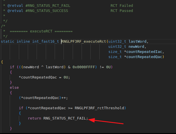

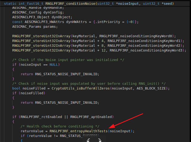

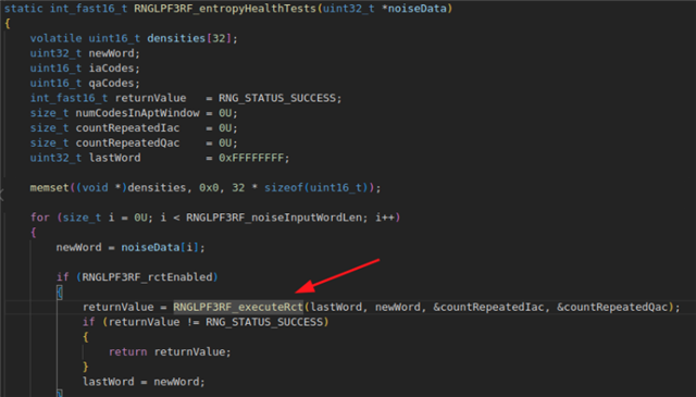

    I could trigger the bug with debbug connected as I said before. As seen below, when the bug is triggered, I can't generate random bits, with return error "-8", which means the RNG subsystem was not initialized.
    It was not initialized because RNGLP3RF_conditionNoise returned a error code "-32"
    Triggered by HealthTests failing, as seen in the following sequence:
    And error "-32" is defined here:
    So I could isolate the bug very precisely, but I don't know what is causing it. Could you provide any guidance on what else I could investigate here from the firmware side? And what hardware aspects could influence the RNG's Health Tests that we should verify?

      rclStatus = RCL_AdcNoise_get_samples_blocking(localNoiseInput, RNGLPF3RF_noiseInputWordLen);
      if (rclStatus != 0)
        FATAL_ERR();
      // Initialize the RNG driver noise input pointer with global noise input array from user //
      result = RNGLPF3RF_conditionNoiseToGenerateSeed(localNoiseInput);
      if ( rclStatus != 0)
        FATAL_ERR();
      RNG_init();
      handle = RNG_open(0, NULL);
      if (!handle)
        FATAL_ERR();
      result = RNG_getRandomBits(handle, randomBytesArray, RANDOM_BYTES_SIZE * 8);
      if (result != RNG_STATUS_SUCCESS)
        FATAL_ERR();
      //while(1){}
    //  zb_ti_f3_main();
      return NULL;
    #if !defined(NORTOS)
        //PMCTLResetSystem(); // Adding this line do not helps
      /* Call driver init functions */
      Board_init();
      /* Set priority and stack size attributes */
      retc = pthread_attr_init(&attrs);
      if (retc != 0)
        /* pthread_attr_init() failed */
        FATAL_ERR();
      priParam.sched_priority = 1;
      detachState = PTHREAD_CREATE_DETACHED;
      retc = pthread_attr_setdetachstate(&attrs, detachState);
      if (retc != 0)
          /* pthread_attr_setdetachstate() failed */
          FATAL_ERR();
      retc = pthread_attr_setschedparam(&attrs, &priParam);
      if (retc != 0)
        /* pthread_attr_setschedparam() failed */
        FATAL_ERR();
      retc = pthread_attr_setstacksize(&attrs, THREADSTACKSIZE);
      if (retc != 0)
          /* pthread_attr_setstacksize() failed */
          FATAL_ERR();
      retc = pthread_create(&thread, &attrs, main_task_function, NULL);
      if (retc != 0)
          /* pthread_create() failed */
          FATAL_ERR();
      /* Start the FreeRTOS scheduler */
      vTaskStartScheduler(); /* does not return */
      return (0);
    Have you submitted your hardware design to SIMPLELINK-2-4GHZ-DESIGN-REVIEWS for further review?
    TI's SW R&D Teams have advised against turning off the RNG Health Tests, so we should further replicate and debug this issue.
    I had not caught that before.  I am unable to replicate the issue with the CC2340R5RKP despite 100+ button presses, and don't currently have a CC2340R5RGE to test but I will try to find one in the upcoming week.  Have you tried using your test firmware on a CC2340R5 RKP LaunchPad?  I'm also interested in the device variation you've noted.  Can you confirm that you referenced the Using the RGE QFN24 package variant guide and are using the F3 SDK dependency versions that I listed in my past reply?
    I will pass this information along to SW and Radio R&D for further review.

  • Hi Tiago,
    Does your example pass more regularly when adding in an iterative loop?
    // Fill noise input from RCL //
    // RNGLPF3RF_noiseInputWordLen is external variable from RNGLPF3RF.h
    // Collect noise input from RCL till input has enough entropy.
    for (i = 0; i < 10; i++)
        if (rclStatus != 0)
            // Handle error
        rclStatus = RNGLPF3RF_conditionNoiseToGenerateSeed(localNoiseInput);
        if ((rclStatus == RNG_STATUS_RCT_FAIL) || (rclStatus == RNG_STATUS_APT_FAIL) ||
            (rclStatus == RNG_STATUS_APT_BIMODAL_FAIL))
            continue; // retry if health checks fail
        else if (rclStatus != 0)
            // Handle error
        else
            break; // break out of loop if success
    I got this idea from the Migration Guide and RNG file reference, and it produced different behavior on my CC2340R5RGE.  It crashes after 100 attempts but not where the GPIO is lit, and I don't fully understand this yet.  I'm still employing help from R&D.  I moved the PowerLPF3_ResetReason code to after Board_init although I am not sure whether this changed anything.

    #include <ti/drivers/RNG.h>
    #include <ti/drivers/rng/RNGLPF3RF.h> // required for external syscfg variable RNGLPF3RF_noiseInputWordLen
    #include <ti/drivers/GPIO.h>
    // Use RNG
    #define RANDOM_BYTES_SIZE 16u
    // Use the function provided by RCL to read noise input //
    extern int_fast16_t RCL_AdcNoise_get_samples_blocking(uint32_t *buffer, uint32_t numWords);
    uint8_t randomBytesArray[RANDOM_BYTES_SIZE] = {0};
    uint32_t localNoiseInput[152]; //Minimum array size 80 words
    void *main_task_function(void *arg0)
      RNG_Handle handle;
      int_fast16_t rclStatus, result;
      ZVUNUSED(arg0);
      Log_printf(LogModule_Zigbee, Log_DEBUG, "initialized");
      //  RNG_fillPoolIfLessThan(RNG_POOL_BYTE_SIZE);
      // Clear noise input //
      memset(localNoiseInput, 0, sizeof(localNoiseInput));
    for (uint8_t i = 0; i < 10; i++)
        if (rclStatus != 0)
            // Handle error
            // Handle error
        else
      RNG_init();
      if (!handle)
        FATAL_ERR();
        FATAL_ERR();
      //while(1){}
      GPIO_setConfig(CONFIG_GPIO_BTN2, GPIO_CFG_IN_PU | GPIO_CFG_SHUTDOWN_WAKE_LOW);
    //  zb_ti_f3_main();
      return NULL;
