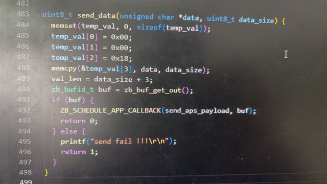

  • Is there any tool available to capture the logs of the cc2340R5? I noticed that the tools provided by the official are all for other chips. I have tried changing the Zigbee channel in SysConfig to 15-2425 MHz and supplying power using the 3V3 of XDS110 for the LP power supply. I have one coordinator and one terminal ZED device. The signal status "ZB_ZDO_DEVICE_UNAVAILABLE" appeared. Is it possible that there is something wrong with the logic of my application layer that has affected the MAC layer and APS?
  • This is the sending function I use. I have created a new thread apart from the main_task_function of Zigbee, and I execute the desired logic on this thread.
    You can use the Insert -> Code tool to place code segments into your E2E response.  It appears that the send_aps_payload function is sampled from the Zigbee Fundamental Project Development which is fine, and making sure zb_buf_get_out returns valid before scheduling the send_aps_payload callback is a good practice. Be aware that there are Zigbee memory APIs (ZB_MEMCPY->zb_memcpy, etc) in the zb_hal_utils.h->ti_f3_main.c files.
    I assume the send_aps_payload_cb is where you are getting the Transmission status, and it would appear that they have been successful before the missing APS ACK.  You could disable the APS ACK requirement by setting the third-to-last parameter in zb_aps_send_user_payload to ZB_FALSE, but I'm not sure whether that is directly related to ZB_ZDO_DEVICE_UNAVAILABLE.  Your aps callback will need to free the param in any instance.
    I don't have the context behind the new thread, but you could disable this thread and test only the Zigbee task to determine whether the issue persists to isolate the problematic area.
