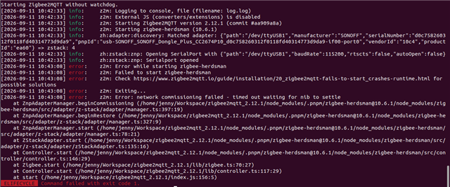

    I can provide the logs from the zigbee2mqtt startup failure, as follows:
    Starting Zigbee2MQTT without watchdog.
    [2026-09-09 10:16:32] info: 	z2m: Logging to console, file (filename: log.log)
    [2026-09-09 10:16:32] info: 	z2m: External JS (converters/extensions) is disabled
    [2026-09-09 10:16:32] info: 	z2m: Starting Zigbee2MQTT version 2.12.1 (commit #aa909a8a)
    [2026-09-09 10:16:32] info: 	z2m: Starting zigbee-herdsman (10.6.1)
    [2026-09-09 10:16:33] info: 	zh:adapter:discovery: Matched adapter: {"path":"/dev/ttyUSB1","manufacturer":"SONOFF","serialNumber":"d0c758260312f0118fd40314773d9da9","pnpId":"usb-SONOFF_SONOFF_Dongle_Plus_CC2674P10_d0c758260312f0118fd40314773d9da9-if00-port0","vendorId":"10c4","productId":"ea60"} => zstack: 4
    [2026-09-09 10:16:33] info: 	zh:zstack:znp: Opening SerialPort with {"path":"/dev/ttyUSB1","baudRate":115200,"rtscts":false,"autoOpen":false}
    [2026-09-09 10:16:33] info: 	zh:zstack:znp: Serialport opened
    [2026-09-09 10:17:07] error: 	z2m: Error while starting zigbee-herdsman
    [2026-09-09 10:17:07] error: 	z2m: Failed to start zigbee-herdsman
    [2026-09-09 10:17:07] error: 	z2m: Check https://www.zigbee2mqtt.io/guide/installation/20_zigbee2mqtt-fails-to-start_crashes-runtime.html for possible solutions
    [2026-09-09 10:17:07] error: 	z2m: Exiting...
    [2026-09-09 10:17:07] error: 	z2m: Error: network commissioning failed - timed out waiting for nib to settle
    Note: When I change ZDSECMGR_TC_DEVICE_MAX to 100, zigbee2mqtt does not produce this error log and starts up normally.

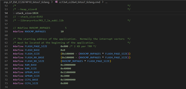

  • Hello jun cao,
    To confirm your setup is similar to the below pictures:
    As a separate question do you plan to go to production with the CC2674P10 with zstack?
    Alex F
  • Hi  :
    I have configured the settings based on the screenshot you provided, as shown below:
    However, zigbee2mqtt is reporting the same error as before, as shown below:
    Yes, but during our testing, we found that when the CC2674P10 is used as the coordinator, only 40 devices can be added to the Zigbee network. This number is too low, so we submitted the issue to E2E to see if a solution could be provided.

  • Hello jun cao,
    Thank you for sharing the document that showed how you modified the config, I took a quick look at this document to see if there could be something affecting the device and there was one section for now that we can try to modify.
    At around line 160 of the patch, I see the following below, we possibly need to also set this to 10 for the NVPAGES if you had not already in your process before.
    +#ifndef EM_CC2674P10_LP
    + #undef NVOCMP_NVPAGES
    + #define NVOCMP_NVPAGES 3
    Alex F
    Thank you for your reply.
    I added '#define NVOCMP_NVPAGES 10', but the error in zigbee2mqtt remained the same.
    Initially, when NVOCMP_NVPAGES was at the default value of 5, zigbee2mqtt would throw an error after I changed ZDSECMGR_TC_DEVICE_MAX from 40 to 100. However, when I changed NVOCMP_NVPAGES from 5 to 10 and ZDSECMGR_TC_DEVICE_MAX from 40 to 100, zigbee2mqtt started successfully. I believe NVOCMP_NVPAGES determines the maximum value for ZDSECMGR_TC_DEVICE_MAX.
    Consequently, I changed NVOCMP_NVPAGES to 15 and ZDSECMGR_TC_DEVICE_MAX to 200, but this resulted in a compilation error. Could you please take a look at this?
