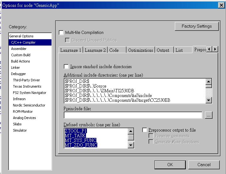

  • How often does your application call GenericApp_SendTheMessage()? If I remember correct, it is called every 5 seconds. If your UART host application send UART message too fast and GenericApp_SendTheMessage is called only once every 5 seconds, there is problem in RX buffer.
  • what should i do now ??
  • Try to change GENERICAPP_SEND_MSG_TIMEOUT to 200. And tell me how often you send 12 byte from UART host applicaiton to CC2530.
  • #define GENERICAPP_SEND_MSG_TIMEOUT 5000 should i change it to 200????i send data 3 times in a minuite
  • Your current implementation is polling for UART information and I think it is not a good idea. I suggest you register a UART RX callback and call GenericApp_SendTheMessage to send message when there is RX data coming.
  • any example for this ???
  • You can refer to MT_UartInit() and RX callback is to refer to uartConfig.callBackFunc.
  • but actually my issue is that buffers not clear i dont think it will resolve with this approach what u say
  • You said "i send data 3 times in a minuite". May I know the data you send in this 3 times?
  • Maybe you can try to remove the following define from compile options
    ZTOOL_P1
    MT_TASK
    MT_SYS_FUNC
    MT_ZDO_FUNC
