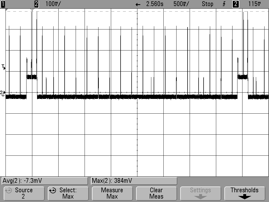

  • Hi
    Did you get it working in CC2530 ZNP Mini. I get the following pulses in between my 4 sec transmission intervals:
    I want to minimize those mini peaks to say once, between those 4 seconds, any ideas pls help!!!
    Iam using CC2530 ZNP Mini
    -Sree

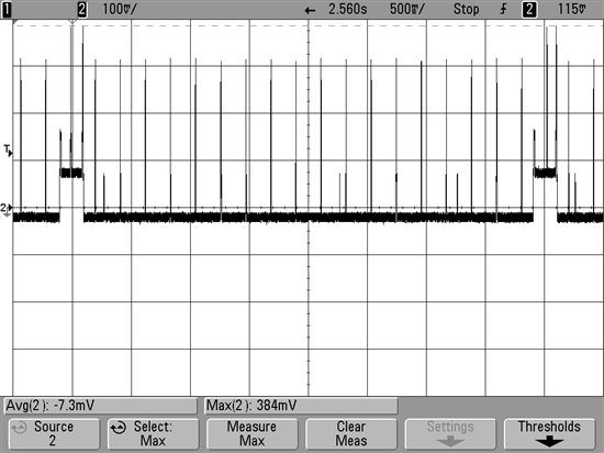

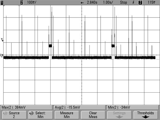

  • Hi Li,
    Iam also using CC2530 ZNP Mini, running simple application code.
    I had put up the same question in another forum to which I got the response to consider the the poll rate. Posting one of the posts in that query here:
    I read about ZCD_NV_POLL_RATE and figured out, it is set by void setPollRate(unsigned int pollRate) function in znp_interface.c, however amazingly there is no call to that function in Simple Application - End Device code (searched manually and ctrl+F deep search). So I manually included the following lines of code in startZnp (@znp_simpleapp_utils.c) after znpReset
        setPollRate(2000);
        if (znpResult != ZNP_SUCCESS)
            return -11;/**/
    which provides me this plot:
    which was earlier, (before the above manual setPollRate(2000) inclusion):
    While that is certainly a difference in the plot, I couldnt map the 2000mS, and more importantly, how is that 1Sec interval set by default with no call to setPollRate in original Simple Application - End Device. Atleast, if I know the root of that 1Sec interval and how it is set (since setPollRate is not called exclusively), I could further dig around.
    -Sree
