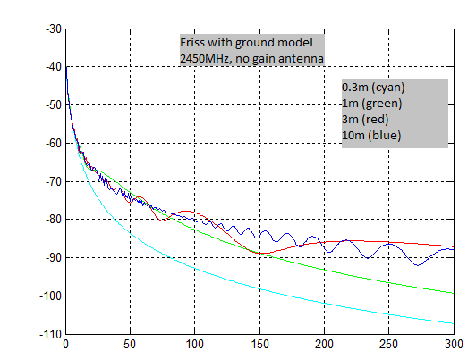

Does ground reflection have huge effect on CC2530?? I am wondering if any measurement has been taken in TI regarding the performance of CC2530/CC2531 when using them quite near the ground, say 20-30cm height from the it.
I used two CC2530 modules to communication with each other at 4dBm transmission power with the SMA antenna. Then I found them lost the communication at a distance of about 30 meters. And it became worse when using CC2531 dongles (with PCB antenna) which gave a communication range of only 15 meters. Those measurements were taken in a flat open area with concrete road and lawn and the modules were put 20-30cm from the ground. I think that is due to the ground reflection/deflection that ruins the communication. Does anyone have any idea of this phenomenon??
Although TI claims that CC2530/CC2531 can reach a range of about 450 meters. But those measurements were taken in a way that the modules were placed at least 1 meter from the ground when I watched the videos. 1 meter is quite long when comparing with the wavelength of 2.45GHz, so the ground reflection may not have much effect on the modules. In my application, however, some modules will be put at that height of around 20-30cm. So do you think I can still use CC2530/CC2531 in my case? What if I apply CC2591, the power amplifier in my system? Do you think that will help to reach hundreds meters range in my situation? Or do you think I should find some other alternatives instead of CC2530/CC2531? What is your idea of that?

    We have an appnote discussion this topic including a simple Matlab script to simulated the performance.
    http://www.ti.com/lit/an/swra169a/swra169a.pdf
    So datasheet for CC2530, but you need some margin for multipath fading. Some say 10dB some say 20dB. Lets go with 10dB. From this I estimate 75 meters at 0.3m off the ground, 150meter at 1m off the ground, and 250meter at 3m and 10m off the ground.
    As the car industry says - mileage will vary based on conditions, please use these numbers with caution.
    /TA

    That explains my observation. So if ground reflection has that much effect on the radio performance, what do you think I should do to get 100 meter range?
    In my application, the transceivers will be placed at 20-30cm off the ground which is a must. I could see two options: 1. use CC2591 power amplifier, 2. choose other solutions at 800-900MHz. Which do you think will much guarantee  the performance?

    Sub1Ghz (868MHz (EU) and 915(US)) is very popular for exactly the reason of getting range. Say you use a CC1190 range extender, you get approximately 120dB link budget. Then subtract the same 10dB as before and you have to use the 110dB point on this curve and you end up at 700 meters.
    If you cannot afford the extra transmit power of a CC1101+CC1190 combo, I would suggest a standalone CC1120 at low data rates. This device with get -120dB link budget without range extender but the datarate becomes low ( <10kbps)
