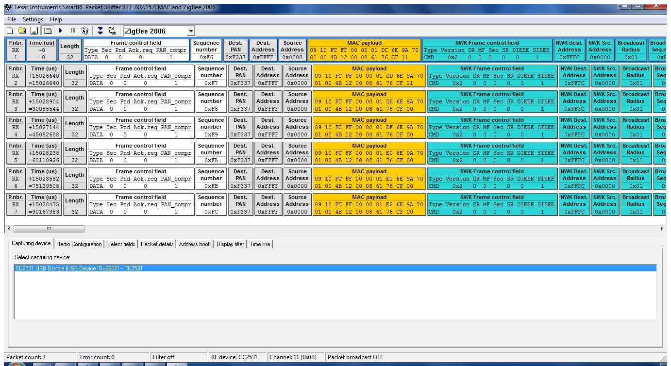

    i then ran the packet sniffer using another cc2531 and i got these packets
    Next ,i powered  a cc2530 end device - using battery ( programmed using CC2530ZNP Mini kit end device example )
    now i got these packets in packet sniffer.
    but i was not able to read any data in hyperterminal when i connected it to the cc2531 usb cdc serial port

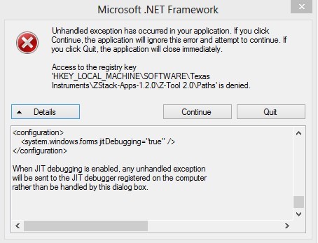

  • Thank you YiKai Chen,
    But i encounter the following error when i open the Z-tool under z stack
    Unhandled exception has occurred in your application..
    i have included the screen shot

  • I would suggest you to find a PC which runs winXP or win7 to use Ztool on it. Do not waste time on windows 8.
  • Thank you YiKai Chen...
    i tried it on another windows 7 pc
    it still shows the same error.

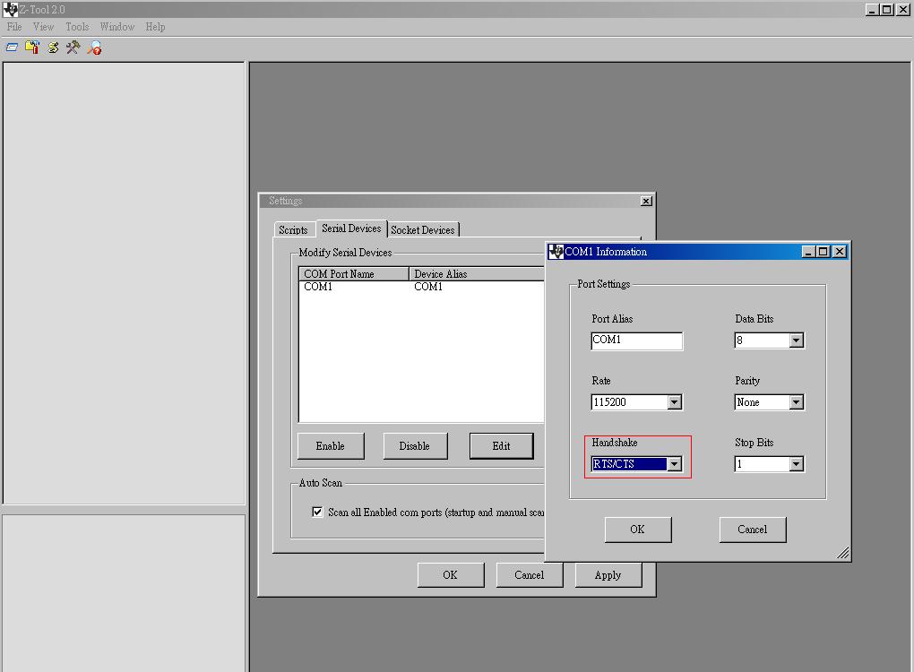

  • Please check your handshake setting in the com port of you ZTool. You nee to choose RTS/CTS when using ZNP via serial port.
  • Thank you Yikai Chen
    i changed the setting to cts/rts , but it still says " NO Devices Found "
    can you please tell me how to use MT commands  as you mentioned above
