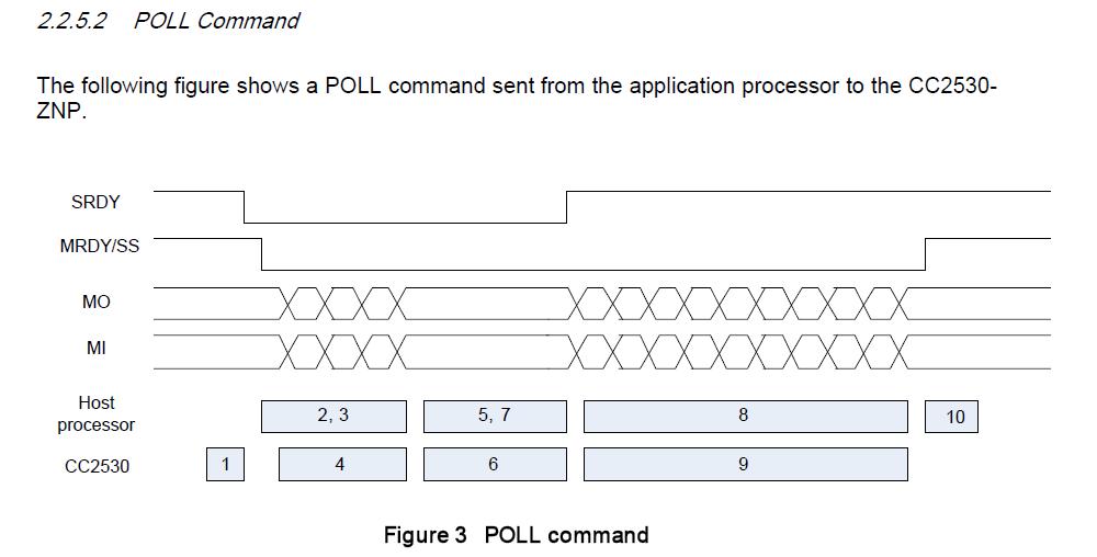

CASE 2:
From CC2530 interface Spec, the sequence is as follows,
1. We are waiting for SRDY to become LOW.
2. We are making MRDY to LOW.
3. Write POLL command to cc2530.
4. Wait for SRDY to become HIGH.
5. Read from CC2530
6. We are making MRDY HIGH.
From the above two cases,
  • in case-1 we are writing to CC2530 when SRDY is HIGH as per code.
  • in case-2 we are waiting for SRDY to become LOW, to write to CC2530.

  • Hello Anil, zapPhySpiRun() function is called to get the ZNP out from Bootloader mode and force it to the application code. To do this the ZAP Application code waits until the SRDY line goes low, this is how the bootloader code indicates that it is ready to receive command from the host to either put it in bootloader mode where it can receive new image or force ZNP out of bootloader mode and jump to ZNP application code.
    The interpretation of the HAL_ZNP_SRDY_SET() is this is one when SRDY is low. So in your description in case 1. We still wait for SRDY to get low. When SRDY is low we set MRDY low and send the command. So, once the HAL_ZNP_SRDY_SET() = 1 (or when SRDY is low) the ZAP sends the force to application code command and the ZNP application code starts getting executed. Once in application code, you can refer to the ZNP Interface Specification document for how to communicate with the ZNP. You can also see the ZNP bootloader code at C:\Texas Instruments\ZStack-CC2530-2.5.1a\Projects\zstack\Utilities\BootLoad\CC2530ZNP
    Hope this clarifies. Regards
