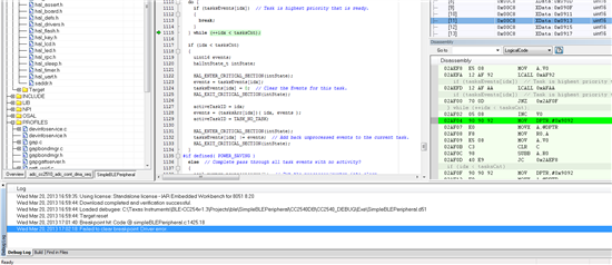

I am trying to debug my code, but IAR will not allow breakpoints to be set.
The Debug-Log window states "Failed to clear breakpoint: Driver error" as shown in the following image (CLICK TO ENLARGE):-

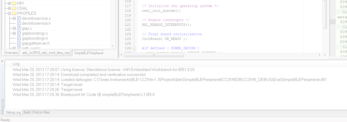

    I am also, sometimes, getting the following screen, where IAR acknowledges the breakpoint but between IAR and Windows, I get the greyed out screen (as shown below - CLICK IMAGE TO ENLARGE) and infinite looping blue circle.
    I get the message "Breakpoint hit: Code @ simpleBLEPeripheral.c:1385.8"
    It all locks up the same as above....

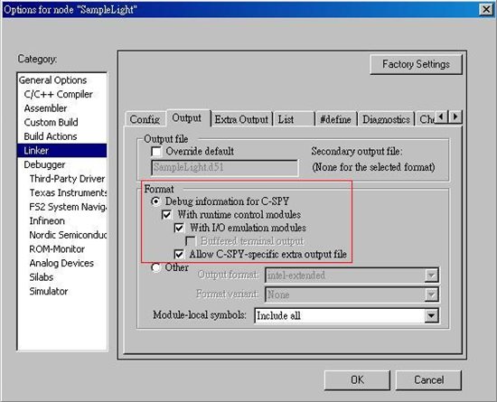

  • Check if the settings in Linker Output of your project is like the following image.

    This is the kind of thing I suspect is wrong, but my settings are the same as those shown in your image I'm afraid, so this is not it.
