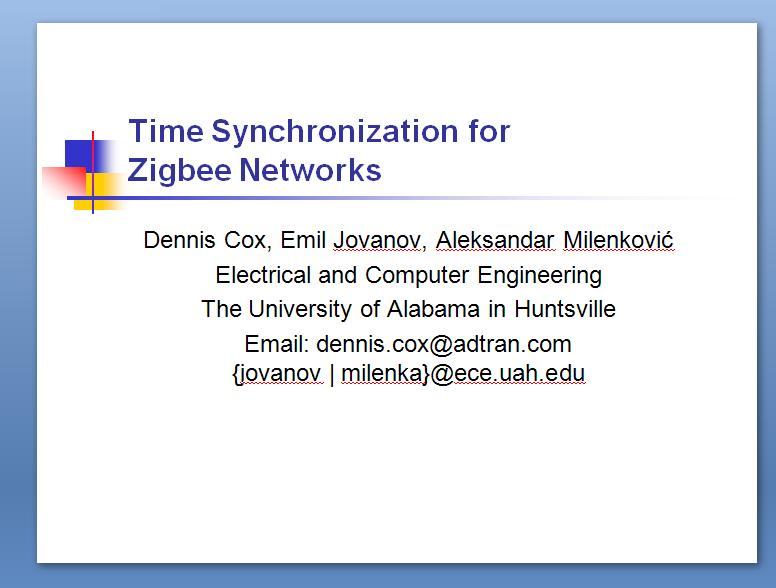

  • I found a presentation that points to a possible problem solutions.
    This is the link to the PowerPoint:
    www.ece.uah.edu/~milenka/docs/am_ssst05_synch.ppt
    We are applying FTSP and one of the obstacles that we are finding are the 35ms  needed by Zigbee MAC Layer to return to join the network.
    As we have seen a period of 40ms awake and asleep 1 minute on the system could operate with 2 AA for a reasonable periods of 1.5 years.
    Another of the things that we have targeted is that if not necessary to use ZSTACK(Our case), better do so with  TIMAC and development of network and application layer that addresses Low Power Router using Time Synchronization.
