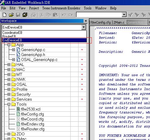

I am getting started with the smartrf boards and zstack, so I am sorry for stupid questions if any. Well, I have two evaluation modules CC2530EM and I would like to get ready to write my first firmware. The generic app seems to be the correct demo to start with, but I am quiet confused because I did not understand how to set a device as end_device, router devise or coordinator_device. At startup, the device starts as coordinator with a random PAN ID and it starts sending the "hello world" every 5 seconds (I can see by the packet sniffer and the dongle). I would like to join the other device as a router or end device in the same network. I think it is something simple,but at the beginning everything seems complicated :). Thank you for the help.
Gianpaolo.
P.S.: it looks like that the binding process by key press does not work. At start up I always get on the display "zigbee coord network ID:..."
