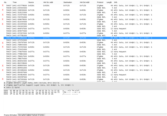

    i tried to attach the sniffer log but it's oversized (over 30MB) and besides that i'm not sure it's understandable since i'm not using the TI sniffer but Wireshark, because i'm using the home automation profile and the TI sniffer doesn't decrypt the data...so i attached a picture of the part of my interest, since it's more immediate to understand. Anyway if you need the log i will try to send it.
    In the picture the messages signed with a red cross are not important to this case because they are messages that the two routers send to each other. The two routers are 928c and 7c2b, while the end device is 377a. 928c is also the parent of the end device. As you can see, on message 56419, 928c routes the request of 7c2b to the end device. Then in the next message, the one highlited in blue, the end device replies directly to 7c2b. Then on message 56429, 928c sends his own request to the end device, and the end device replies to him. In all this process, 928c remains the parent of the end device, because the Data Request are always directed to him.
    So to me it really looks like the end device replies directly to both routers. Another proof of that is that if i cover the antenna of the end device, i see the RSSI decreasing on the reception of both routers: if the message was routed from the parent to the other router, i wouldn't see the RSSI decreasing.
