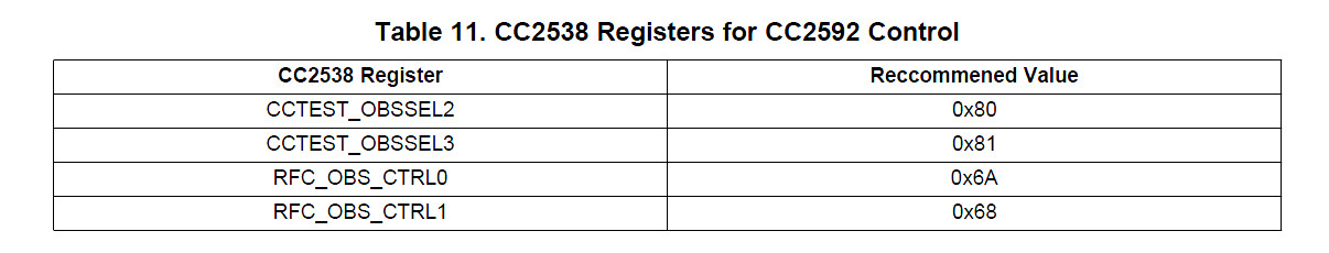

I was very happy to see that the CC2592 is RTM, and I look forward to using it instead of the @#$%# CC2591. When using the CC2530 with CC2591, in Z-Stack (v. 2.5.1) normally you #define HAL_PA_LNA and the correct TXPOWER table is loaded. Is that same table valid with the CC2530 + CC2592? I read the app note:
AN130 - Using CC2592 Front End With CC2538
But obviously that is for the CC2538, not the CC2592. Are any other changes required to the Z-Stack for using the CC2592?
