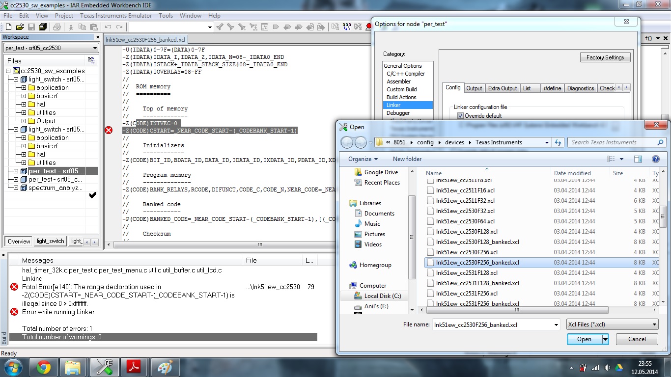

Hi everyone,
Im newbie on Zigbee, I started to with an example. When i wanted to "rebuild all" there is an error like this picture. I think this problem occur i choose wrong linker config file but im not sure which i must choose?
Im using CC2530DK with two board. and writing chip name CC2530F256 , i choose this but still problem here.
"sorry for my english,
thank you.
  H
  • I solved problem, problem is i dont choose in general options "device"
