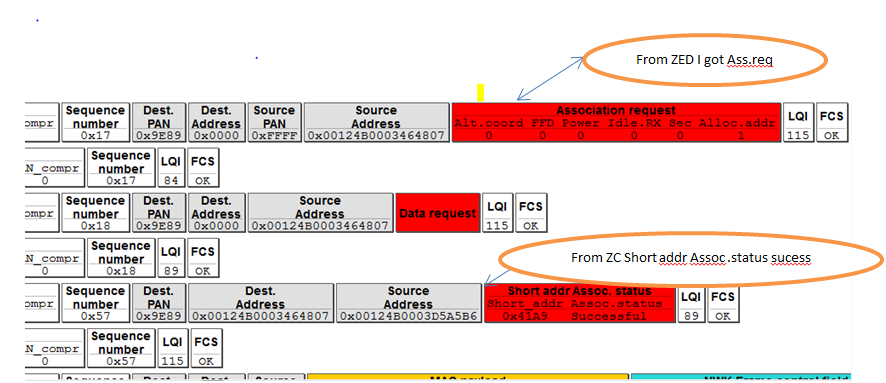

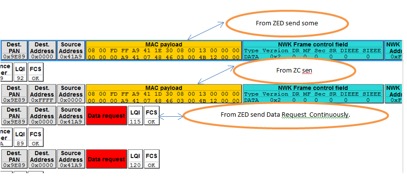

  • Hi Friends,
                     Thanks for your replays and from your ideas only i can get the these packets in my packet sniffer.
    1.i)First image ZED send Association req
    ii)Again ZED send Data request
    iii)ZC send Short addre association status =successful
    2. i)Second image ZED send some data.
       ii)And ZC send some data.
      iii)After that ZED send Data Request continuously .
    My Question:
    1.   I want to know i am going correct way or not.
     2. If the data Request continuously come by the reason of AF_DataRequest() reason or not.
  • 1. From your sniffer snapshot, your ZED joins ZC without problem.
    2. The continuous data request comes from polling rate settings.
