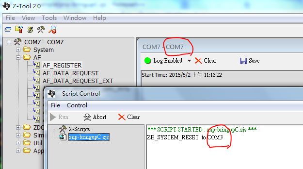

Hi Friend,
I am using cc2531EM usb dongle as ZNP in my PC and i need script programming for the Z Tool 2.0.
Other Parts Discussed in Thread: Z-STACK
Hi Friend,
unfortunately we don't provide library of Z-tool scripts.
I am attaching an example of a simple script to start the NWK (as a coordinator) and to have a router joining the network.
Please note that this is just an example to start from and to guide you through the initial steps of NWK setting and data transfer.
I would suggest you take a look at ZNP API document for more sophisticated scripts development.
