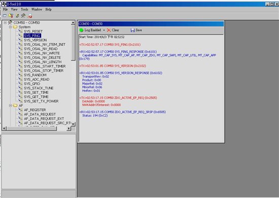

                   I am working with one ZC and one ZED and cc2531 dongle as ZNP.And i try to send command from Z tool 2.0 to initialize the network.
My Q:
1.when i send ZDO_Active_EP_REQ i doesn't get any information about the end device or even coordinator also doesn't send any response?

    In my module i reprogram my Packet Sniffer cc2531 EMk to ZNP-Pro-HexFiles and connect with my PC.Using Z Tool 2.0 i am sending some software Startup procedure as described in CC2530ZNP Interface PDF.I I can get my some success reply.But I don't know it's write or not because mostly it send some success reply.
    My Q:
    1.When i send the SYS_PING, SYS_VERSION, and ZDO_ACTIVE_EP_REQ commands i can't get reply?
    2.When i send SYS_PING from  Z Tool whether it expects the RX message from ZNP or some other device connected       (as ZED )in the network?

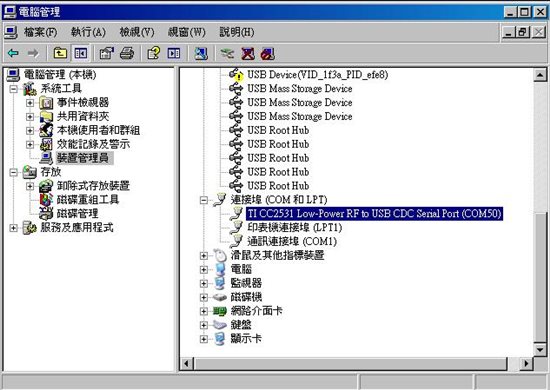

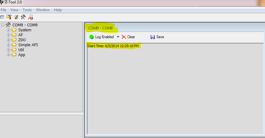

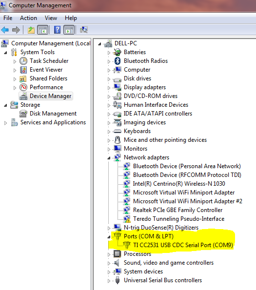

  • Would you show me some screen capture of your Z-Tool and device manager on your PC? Form your description, I don't know how to help.

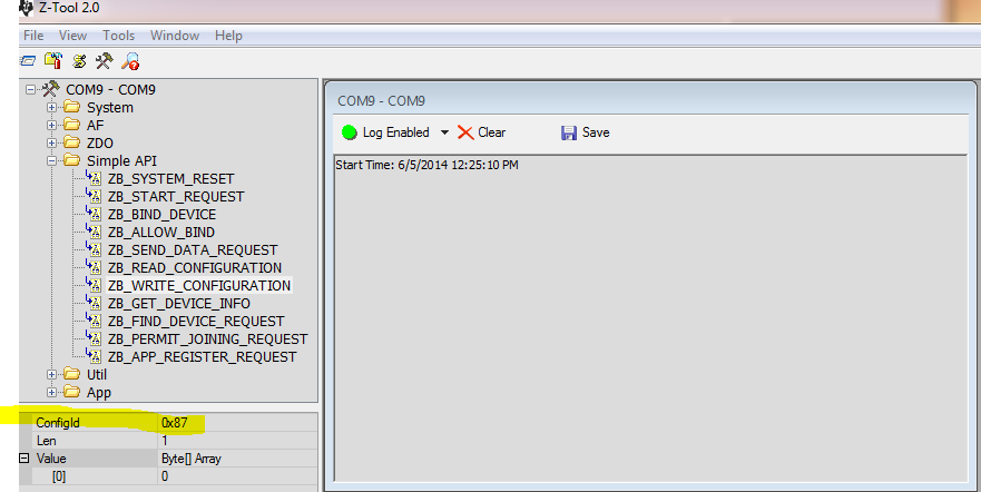

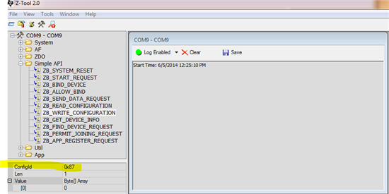

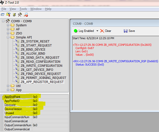

  • Hi YiKai Chen,
    I reprogram the Packet Sniffer as CC2531ZNP-Pro.hex in that project folder.
    set configid=0x87
    I got th RX message for Write_configuration successfully.
    But I don't know how to give the value for AppEndPoint,AppProfileID,DeviceID and DeviceVersion
    Could to reply me how to give the value for these parameters?
    And tell me how u know the endpoint value?
  • You should assign profileID, deviceID, deviceVersion, and end point according to Zigbee spec and your application requirement.

         I done that till ZDO_ACTIVE_EP_REQ and get success message only.
    My Q:
    1.I want to send AF_DATA_REQUEST so what are the command i need to send from Z Tool before sending AF_DATA_REQUEST command?
  • You need to have another end device joins to the coordinator and keep the short address of the end device. Then, you can use the short address to send message by AF data request.
